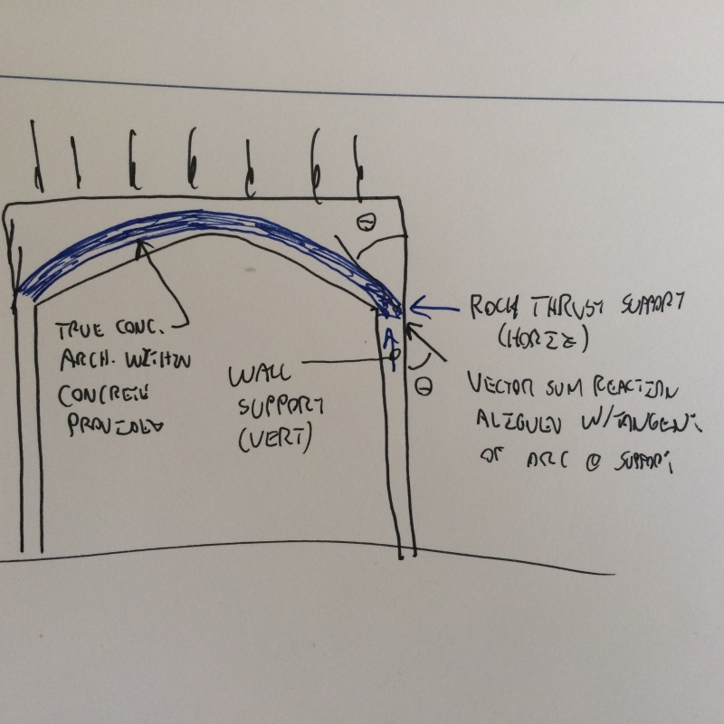

Hello,
I'm a rock mechanics engineer and I would like to calculate my factor of safety of shotcrete arches holding a certain rock weight. The shotcrete arches have the same profile as the excavation drift (15'W x 15'H) but has an arch in it in the back. The shotcrete thickness in the shoulders of the tunnel is approx 10" and 4" in the walls (see sketch).
I was able to calculate the factor of safety of the support by taking into account shotcrete only by diving the capacity of shear resistance of shotcrete along the failure perimeter by the load of the rock on the support system. However, this is conservative because I'm not taking into account the effect of the steel reinforcement. Could you give me guidance on how to account for the steel reinforcement in case of shearing along the shoulder due to the load of the rock on top. I'm sure it's a simple material resistance calculation but I can't quite remember my old course back in university.

Based on your sketch you could treat it as a concrete rigid frame bridge, pinned at the bottom of the legs.

Not much point having 10" depth at the haunch if there is only 4" depth in the column unless the rock on each side is preventing rotation of the beam ends. Normally, the depth of column at the top is the same as the depth of haunch because, in a rigid frame, the moments are equal in the beam and column where they meet.
The solution depends on the assumed boundary conditions, but it seems to me the column will be acting essentially in axial compression with an insignificant bending moment. The assumption of a hinge at the bottom of the legs is not realistic. The assumption of a hinge at the underside of haunch may be realistic, but it means that you will have very large horizontal forces to be resisted by the rock which, depending on the properties of the rock, may be excessive.

I'm not concerned about the horizontal forces on the rock, as the rock we are dealing with is massive and has a high UCS (UCS>180 MPa). I'm more worried about exceeding the shear strength of the reinforced shotcrete arch at the haunch. So that's why I would like to know what would be my shear forces there, my bending moment and see if the used materials (shotcrete + steel) are able to withstand that shearing.

RE: SHOTCRETE ARCHES
Based on the proportions of the "arch", my thoughts are as follows:
1) You're not getting squat for frame action out of the connection to those 4" walls.
2) I doubt that the member would have any hope of resisting the applied loads as a beam element (classic flexure and shear).
3) I think that your best bet is to identify a true arch within the concrete provided and assess capacity based on the compression strength of that arch.
4) The arch just mentioned will require competent thrust capacity in the adjacent rock. It sounds as though you do indeed have that.
5) Conceived of as the arch just described, shear and moment should be non-issues, at least for truly uniform loads.
6) I know a thing or two about structures but I don't know jack about tunnels. Bear that in mind.

The concrete will just serve as lining for the rock arch. Erosion control, if you will. The steel can be left out of the shotcrete, unless you intend to tie it in some way to rock bolts.
As KootK said, the concrete will not work as a rigid frame, or as a beam.
