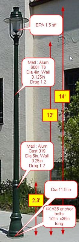

I need help from you guys to recognize few steps from the below calculation for a lighting post. Unfortunately I have no drawing, but quite simple to visualize.
I am clear that the blue color highlighted are need to be updated to current values. The gust multiplier of 1.32 is outdated & believe I will have to use 1.14
The Wind pressure formula also should be modified I believe.
I don't understand the orange color highlighted area. I would appreciate if any one of you help me identify these values/formula used.
  1. In the formula for FP, I don't follow why its 4/12. I think this is got to do with the conversion of in to feet. But not sure what & why?
  2. Similarly in the FB calculation also. what's 12 + 6, where did these come from? I can see 12 is the height of the pole; but whats 6 for?
  3. Under "To Check Anchor Bolts"; whats the 36 for? I guess its KSI value of steel AB? But I am not sure. But I dont understand whats the 1.4 for?
  4. Then under calulation for T, whats the purpose of multiplying with 0.012
  5. To check Base Floor : What is M? I can see that M is calulated by ARM x T
  6. The next one is the calulation for S. It appears, it's a calculation of section modulus. then why /6?
Thanks,
GC

I apologize. Here is a marked up sketch that gives the details.
I know that FP & FB are the Force calulation on Pole & Base. Generally I would think its AREA X WIND PRESSURE X Cd. I couldn't figure the where the 4' & 12'+6' came for inches conversion & why?
Thanks,
GC

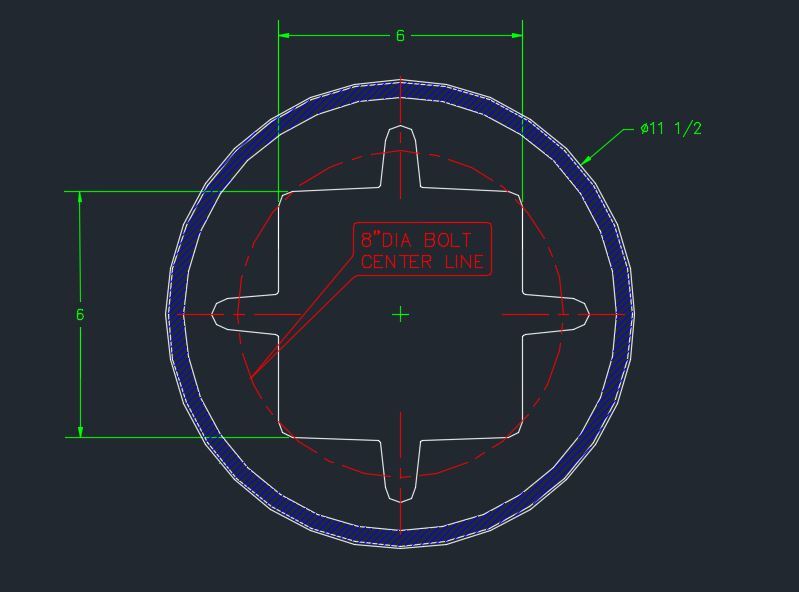

Sounds like the base section modulus calculation is incorrect then. There for, I could quickly create a drawing of the base section near anchor bolts...

I think the 4/12 refers to a 4" diameter pole, converted to feet. It's the wind acting on the projected area.
If that's indeed the case then the (12+6)/12 is probably an incorrect attempt to do the same thing with the average diameter of the pole base. If so then it's another error; it should be [(12+6)/2]/12.

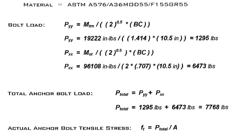

On the anchor bolt calculation I found a formula from another project. From this it's clear that 1.14 is from (2)0.5.
On Base Floor Thickness check his formula is still very unclear. I really need some more help with this please. I don't want to use his values because they might also be a leftover from his previous project. How would you check the base floor thickness? Is there a generic formula for it? The bottom of the base is round like shown on the CAD screen shot above.
