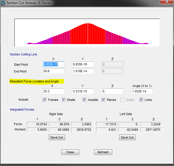

I have made a slab using shell elements. I would like to draw a section through longitudinal direction of slab to view the shear and moments by plotting them in Excel. When I use section cut definition in SAP2000, I tried defining both by group and quadrilateral plane but the output is just as one point. here is the link to what is described by CSI Knowledge Base: Link
This is the slab I want to draw a section cut through its centerline. i already grouped all of these elements and tried defining different quadrilateral plane, but none of them worked.
Any suggestion is appreciated

The section cuts allow you to perform force integration on its entire length so you get one value (F1, F2, F3, M1, M2 and M3) for each section cut. To plot the shear and moment distribution you need to create several section cuts, all along and orthogonal to the longitudinal centre line.
This is a lot of work, creating all the quadrilaterals, so what I usually do is using the import/export to Excel features and generate all section cuts and quadrilaterals in Excel. I'm developing a VBA tool to help but it is still an ongoing side project.
Hope it helps.

Your answers are crystal clear. I guess when a transverse section cut is defined, alpha would be 270 measuring counterclockwise from global X axes to the positive X axis of the local coordinate system in which the integrated forces are reported.
I tried to check accuracy of spreadsheet comparing with drawing section cut in SAP2000, I noticed that it integrates forces at one location when section cut is drawn in graphical user-interface. I checked the values reported by values at same location by spreadsheet, but they're not same at all. Did you try validate its output? i checked for very small xy plane and the results did not match.

To compare with SAP section cut results, section cuts must be drawn transversely not longitudinally, also group cut must be set to ALL--> doing so, Excel and section cut results match!
