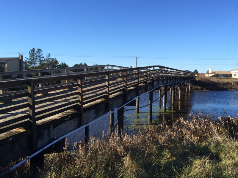

Technically I'm not suppposed to engineer this bridge. They will be replacing the main members and deck exactly as they are currently constructed so as to avoid having to bring it up to code:
My responsibility on the project is to simply document the process, draw an as built of the bridge and provide a scope of work (what members are being replaced etc...) The pilings were inspected and approved by some state agency and were deemed acceptable so those will remain.
In the process of replacing the main members the owner would like to do some minor upgrades:
1.) Provide strapping to secure PT glulam beams to pier system directly below.
2.) Provide strapping between abutting PT glulam beams for continuity and so beams have less chance of "walking" off of their bearing points. This pedestrian bridge services the golf course as well as pedestrian traffic so vibration from vehicles (albeit small) is something to consider.
3.) Provide some form of anchorage between the abutments (concrete) and the end terminal beams. Currently they are just bearing on a concrete ledger without any securing mechanism, see image below:

Technically I am "not to engineer" the bridge, which I find a bit odd, but that is the situation. I've never even looked at a pedestrian bridge before or any type of bridge for that matter. My question has to do with the items listed above. The owner wants some form of "recommendation" as far as straps or anchorage for his minor upgrades. All other repairs are simply to replace the bridge main members, deck and railing as it is currently constructed.
Being familiar with residential work and conventional light frame construction my first inclination is to turn to my Simpson manual. Whether this is a reasonable solution or not is somewhat of a question to me so I want to put it out there for others to weigh in:
1.) Secure beams to piling system with CS14 and 10d stainless nails
2.) Tie beams together at ends with strap nailed to one side of beam, CMST14 and 10d stainless nails
3.) Either a couple of DTT2Z into the side of each beam and a 5/8" all thread epoxied into the concrete abutment or some form of angle bolted into the bearing ledge and then into the beam.

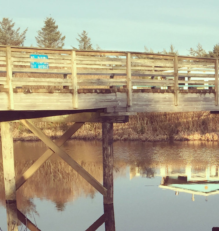

Strange. My first reply was to a post which had only the first picture and the writing above the picture.
I think what you are describing would be considered design or redesign. I don't like to use "engineer" as a verb.

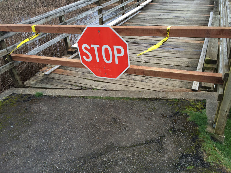

Notice how rotted the main beams are, clearly evident in the second picture above. All sorts of "fix its" have been applied to this bridge to try and keep it serviceable over the years. Before Christmas I came out and did my first quick survey of the bridge and was amazed that they were still driving golf carts across it considering its condition. A quick letter to the owner of the golf course and to the city had them shut it down to all traffic, which then instigated a full scale repair or replacement.

Sorry, I don't see anything in the pictures or the posts that makes me feel good about any of it. You agreed to the as-builts, stick to that with disclaimers hanging on every thing you touch or hold out for an actual design assignment.

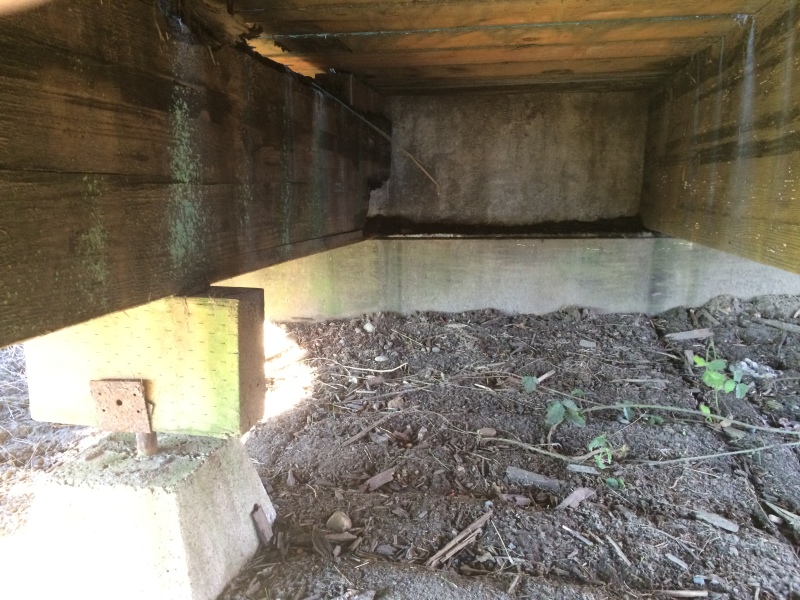

Just to show the condition of the bridge I thought I might post this picture:
Notice the end of the smaller beam, it has rotted to the point it is collapsing down on to itself, kind of scary to think they were just running 1,000 lbs golf carts across it a couple weeks ago.
Of course the major problem with the original bridge construction is the use of non-pressure treated glulams in a very wet environment (olympic peninsula, WA) and it is within a 1/4 mile of the beach.

Medeek:
You ought to be applying some real numbers to the problem. This isn’t just the IRC in its lightest version, where you follow the cookbook and ask a bunch of questions on a forum, to form some engineering determination. If you haven’t got the experience to do this job, maybe you shouldn’t be doing it. Have you read that part of the engineering registration and stamping criteria which says you should only practice in areas where you have experience? Someone has to make an engineering judgement about the foundation of this bridge, its condition and the profile of the pile caps, or you’ll end up with about the same thing you have now, but with newer floor beams and decking. The City Bldg. Dept. is being chicken shit too, in saying replace it in kind or you need an engineer to stamp it. In their case, do they want someone with good engineering experience to evaluate the entire condition of the bridge, P.E. stamp or not, or are they only looking for a cheap-fee engineer who is really acting as the insurer of last resort, through his insurance coverage. There seems to be incredible misunderstanding, partly intentional in today’s world, about the duties, responsibilities and obligations of a registered engineer’s involvement in a project. Why don’t they go directly to a reinsurer if they aren’t willing to pay an engineer for his knowledge, experienced, time and judgement in bettering the outcome of a project? Hell, just go to the big box store, they probably have a program to sell material which will design this for them.
RE: Pedestrian Bridge
Like dhengr, I think you may be in over your head. If you work on this project, no matter the extent of your involvement, you will have bought the liability for the design, because there is no one else to blame if something goes wrong. Mr Simpson is not going to be of use in that regard, even if some of their hardware is applicable, which I doubt.
If I were doing this, the first thing I would want is to see the inspection report and approval by the "some state agency" who gave the pilings their blessing.
