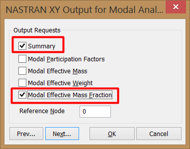

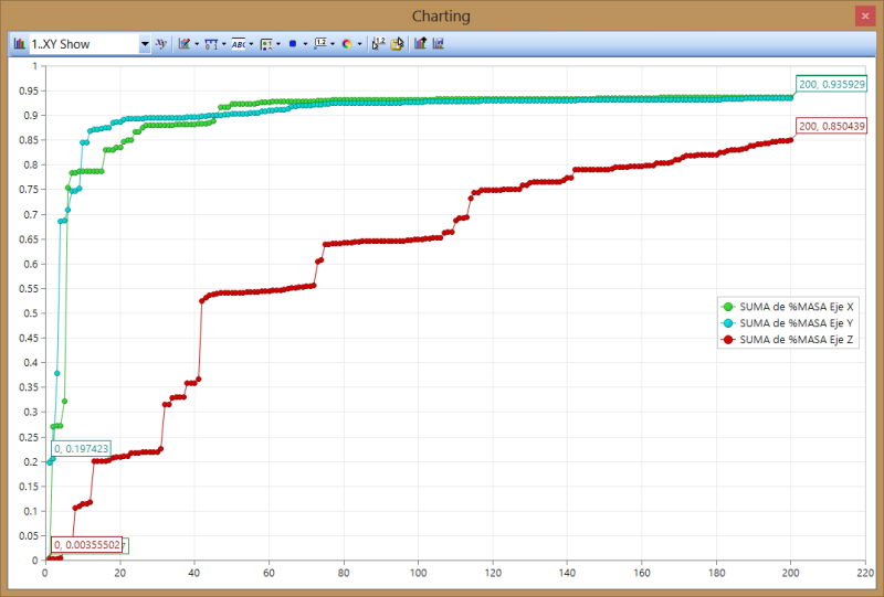

If you refine your mesh then the NX NASTRAN (SOL103) solver will extract more local modes, but the main modes (those with energy) will basically remains the same. I always plot the modal mass participation factor vs. mode number, this way you will see the amount of mass captured, the minimum for any dynamic response analysis is to achive the 85% of the masss of the direction of the excitation.
