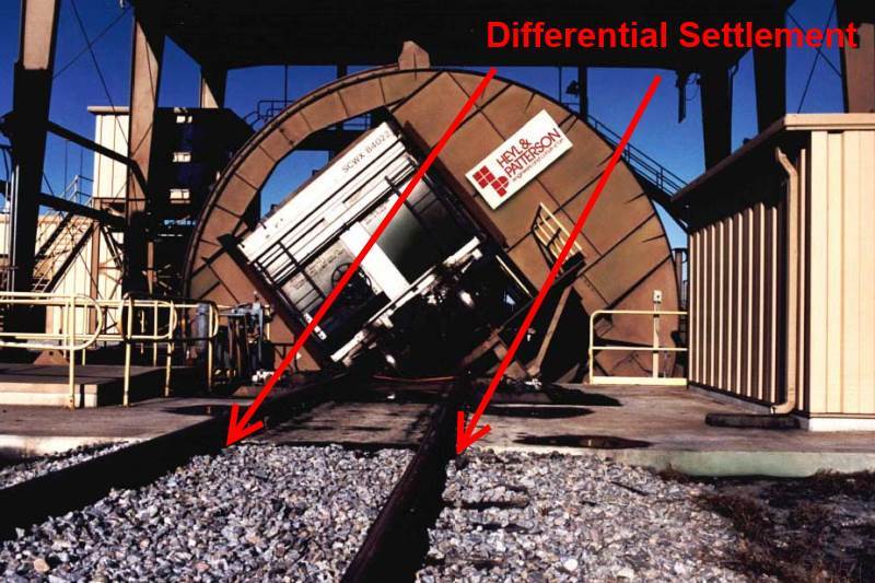

The differential settlement issue is real, we had to deal with it on an ongoing basis at the coal railcar unloaders at electric generating stations. Here is a typical photo, I marked where rail road bed maintenance has been performed for years:
Suggest not ruling out a slab-on-grade without running the numbers. On a small scale (say the 30' length I mentioned) the axles are spread further apart than intuition suggests. While doing design work on one unloader I was surprised how well distributed the axle loads are. After thinking about it, they have to be. Any given railroad bed can support only so much.

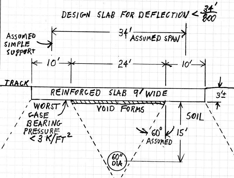

If the void forms shown on your sketch are used under the over-pipe portion of a (30' long x 9' wide x 3' thick) slab-on-grade, I bet the load on the pipe is lower than it would be in the deep foundation sketch (without approach slabs).

I will run a model the way you are suggesting too. I understand your suggestion to be to have a 30-foot long slab with void forms over the top just like I have them now. The difference being that the "foundation" for the structural slab is the portion of slab beyond the void forms on each side for your idea. For this idea, I think you would still need the sheet piling at each end of the void forms to prevent loads from translating at an angle through the soil and onto the top of the pipe.

That's good, either it works or it doesn't... worth checking I believe. If the requirement is for absolutely no applied load (zero) from the rail line, I agree the sheeting is likely required.
Keep in mind two things:
1. The 30' length is my first-order approximation, if a little extra length may be needed. If 35' feet is insufficient, extra length beyond that probably won't help.
2. The rail load on the adjacent track will apply some of its load to the uncased pipe length. Not much, but some. The load distribution footprint thru the soil takes place not only along the length of the track, but also perpendicular to the track.

If you want to try avoid both loading the pipe and installing sheeting try modeling this. Be sure the axle spacing is realistic:
