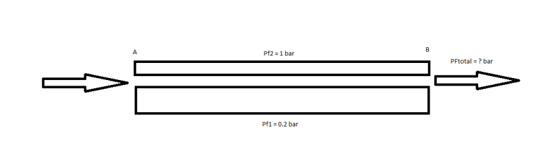

Lets say I have two parallel streamlines for gas between point A and point B, and two parallel streamlines for liquid between point A and point B. Further, I know the friction losses for all 4 streamlines. Then, how can I calculate the total friction loss for the gas, and the total friction loss for the liquid?
PS I suspect that parallel electrical circuit laws can be used somehow [1/RT = Σ(1/Ri) or 1/√RT=Σ(1/√Ri)]

This is the real world, and no, it is not a "homework problem".
I have roughly estimated the frictional losses based on geometry and velocities. The velocities are "first guesses" in the Bernoulli equation, and I will use iteration to find the end solution. But before I can do that, I need to combine the two frictional streamlines for the gas and liquid phase.

I'm asking for the total friction loss for each phase. If all the streamlines were in series, I could simply add them together and have the total friction loss. But they are flowing in parallel, and therefore I'm not sure how to do it. Can it be done by using the circuit laws as I mentioned earlier, or do I need to take another approach?

The only thing you actually know is the pressure drop between your points A and B is the same for each pipe. I hope by streamline you actually mean pipe. Please confirm or otherwise this post is talking rubbish.
You say parallel, but are the two pipes for each fluid the same size?

Yes, I'm talking about pipes. And no, the pipes are not the same size.
I'm asking for a formula to calculate total friction loss for parallel pipes.
I have tried to illustrate it in the picture. Upstream point A and downstream point B, there is a common pipe.

If the two pipes come out of a common header and go back into a common header, then the dP HAS TO BE THE SAME in the two pipes. If you know dP, then you can calculate the relative flow rates (I'd use something with explicit friction factors instead of the shortcut programs). Total friction drop is what you measure in the upstream and downstream headers. I'm not seeing this problem as anything but either impossible or trivial. The volume flow rate in the two pipes is unlikely to be the ratio of the flow areas, just because no two pipes have identical roughness.

Your first point is the fact that your pressure drops in all the pipes is the same. Your variables are many, but flowrate is the first one to resolve.

I'm thinking the two upper pipes (Are the upper two vent pipes of some kind - connected somehow on both ends to liquid service pipes below? ) are going to start vaporizing first, and will be probably mostly gas at saturation conditions for most of the length. If they drain - maybe back to the first reservoir - then they'd be a mix of vapor on the bottom flowing with gravity, and vapor on top flowing with pressure. The condensate could be pushed along though - depends if the upper pipe would ever "plug up" with too much liquid to let the gas go by. Depends too on delta P, and if my guess about drain direction is right.
Lower pipe seems a mix of vapor in the upper pipe and liquid in the lower, unless the pump suction from reservoir 1 is always below the condensate level. Then you'd only have flashing problem down low. Same guess as above: I'd need to a complete 3D model or drawing to begin doing anything but guessing.
