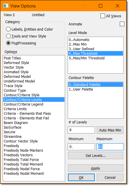

Go to VIEW options (press F6 key) and set the MAX Threshold (I am running the current version of FEMAP V11.2.2):

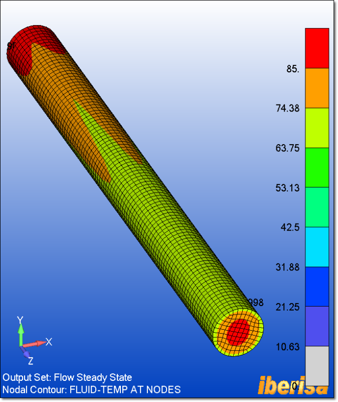

Next plot the result, if I set the maximum level at 85, then in red i will see values above 85:

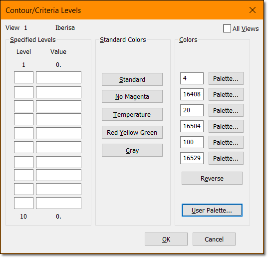

Regarding levels, here you are my options (click in SET LEVELS in the above VIEW Options Postprocessing window), of course, I get rif of horrible magenta color!!:
