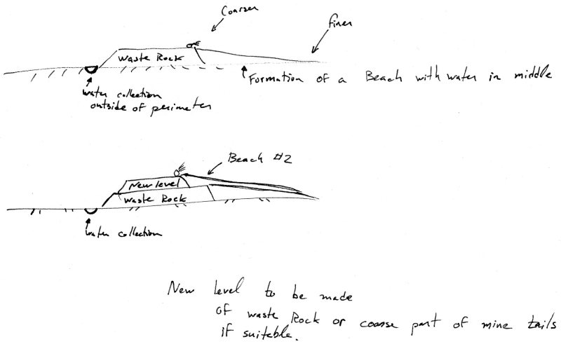

Hey Daine,
One way to overcome problem is to use sedimentation process to separate material size.
It will work better in base metal mine where the grind is coarser.
Gold mines tend to grind very fine and little sedimentation will occur early, so not much beach deposition. Dykes will probably need to be raised out of waste rock in that case.
See drawing below.
I have also seen mines with ''impervious'' dykes with clay or Saprolite cores to retain tails, but these dykes were not made of tails.
If size separation is to be achieved through cyclones, ask the mineral processors as they are the ones who usually run cyclones and do the size separation at the mill. They're use to it, for they do it and send the coarse parts to regrind. They will come to you with a proccess sheet that represent what process you need to achieve what you want. But their proposed process may not fit your process and cost you money.
Cheers
Also, do not expect only water in water collection, fine tails will get there. Drawing was already done and scanned. Sorry.
