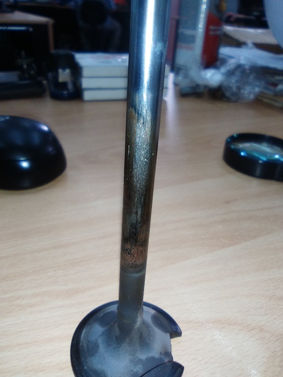

Hi everybody! Please take a look at these photos. An exhaust valve failed in an automotive natural gas engine. The engine is new, just 1400 hours (around 28000 Kilometers). Operator complains about low output power and vibration. No remarkable fault codes logged in ECU (just 3 counts of oxygen sensor). Boroscope reveals failure. When disassembling, there was a lot of clearance between this valve and its guide. When taken out, bechmarks are noticed in the valve crack, consistent with mechanical fatigue. The valve guide diameter was fine at the top, but much much wider at the bottom. Seems that there was a a bad valve sitting (by the uneven pattern in the seat). But more interesting to me is the crack following a circular pattern and the order of the events. According to your expertise, what do you think happened here? what happened first? the fatigue failure or the out-of-round in the valve guide? Any positive suggestions are welcome. Thanks.

The guide wear might be a result of overheated valve. The seat is badly recessed for a new engine also pointing to a very hot valve. Some aspects of the failure look quite brittle - I would get a hardness test on the valve head.

This appears to be a pretty good example of what we used to call a "chordal fracture", one of the pictures shows the fatigue fracture beach marks radiating from the initiation point, and the rougher area indicates the final fracture.
In most of the engines I am familiar with this type of failure was usually due to exhaust temperatures in excess of 1200 degrees F. So the question above about this being a stoich or lean burn is important. Do you have any form of exhaust temperature monitoring? Another possible cause was valve seats and heads not concentric, again as pointed out above.

it looks like the valve never has been correctly seated. what happens then is that the stress on the valve face is not evenly distributed but that somewhere on the circumference a "stress raiser situation" occurs. that may lead to a initial crack that later on results in the damage seen. when the load is not evenly distributed also a bending moment will be introduced into the valve stem resulting in uneven wear of the valve guide.

I would guess (and at this point I emphasize the word "guess") that the valve did not seat properly and an exhaust leak caused unequal circumferential heating of valve, with related hoop compressive yield when hot and crack propagation during the cooling cycle.

Looks like running lean, the valve stem even discolored? Lots of heat, even what looks like recession on the face.
What material is it, and looks like hard material? Heat stress failure.

Take a look at the valve stem, seems that the exhaust gases passed through the seat and burned the stem far beyond the valve head.

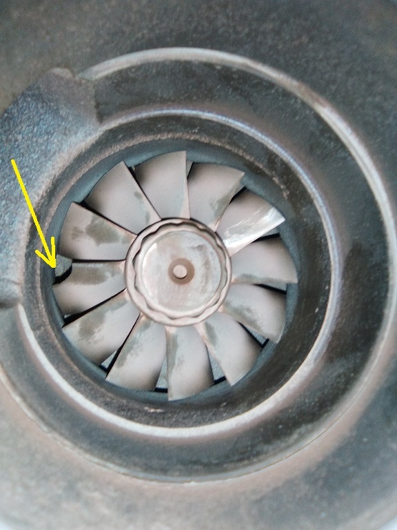

ECU has logged an overspeed event It reached 3400 RPM and 4300 RPM in two different dates. The governed speed is 3100 RPM. At 3100 RPM, ECU cuts off fuel injection. The 3400 rpm event last less than a second, so I think was due to bad gearshifting. But I'm skeptical of this engine reaching 4300 RPM and be alive to tell the story, with just ONE cracked valve. No damages in block, pistons, liners, valves, crankshaft, camshaft, rockers or pushrods. Just piston and cyl head #2 are damaged, due to the fallen pieces of the cracked valve smashed between piston and cylinder head. Being the governed speed 3100 RPM, at 4300 RPM I would expect block shattering or piston destruction. Am I right?
Turbo also has a cracked blade in turbine wheel. Since the turbo wheels are spinning at 100 to 200 thousands RPM, Is it possible for the dettached valve pieces to hit the turbine wheel and damage just ONE blade? Does the valve debris broke down into small pieces before reaching the turbo? Most of them perhaps went out through the open wastegate and reached the exhaust pipe, and just a small one debris hit ONE turbine wheel. Not sure, due to high turbo speed.

Without knowledge of the engine it is impossible to predict the consequences of a 32% overspeed. Many engines will survive a brief event like that without bottom-end failure. It is possible however that valves have hit piston crowns (any evidence on the pistons?) and this valve may have been bent as a consequence. That would certainly explain just about everything.
Debris ingestion usually damages the other end (the tip) of a turbine blade and usually all of them - not just one. You need to get the turbine housing off to inspect the entire wheel. The damage is usually bent and eroded blades - not cracked.

The other valves show no sign of contact with piston. The valve problem is strictly heat related. The over speed shouldn't do a thing, especially the very short time. Yes the pieces can do damage else where like shown.
