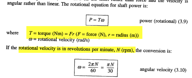

In the study of Engineering I am constantly plagued by the haphazard use of symbols. The latest offence was this (from my textbook which shall remain unidentified to protect the guilty wink)
My author has moved from using 'N' for Newtons to using it for rpm (arguably, for a Number of rpm) without pausing for breath.
Everyone will have seen this lack of consistency; everyone will have their favourite horror story. However, before we censure anyone for lack of discipline we have to establish whether the rules for such discipline exist. Therefore, my question is, "Is there an accepted standard set of individually distinctive symbols for engineering values? Since I haven't been able to find one, I am of the opinion that such does not exist (I would appreciate being corrected bow) so I have to add the question, "Is such a thing possible?

You're just confusing variables with units' symbols. There's no inconsistency (offence) here. Force, F (N). Rotational velocity N (rpm) or ω (rad/s).
Many people make problems for themselves by using unit names as variables. I often see "rpm" as a variable name (in computer programs and formulae). I've never seen "N" as a force variable though, and your author clearly doesn't use it either.

"My author has moved from using 'N' for Newtons to using it for rpm "
It looked to me italicized N was used for rpm, and non-italicized N for Newtons.
My recollection is lower case N (n) appears for rpm from time to time in some industries.
like this -
http://www.chiaravalli.com/pol/pdf_motori/SIMBOLI....
Yes, a reference table up front would seem to be good manners.

I too see no offence in using N for Newtons then N for angular velocity. In one case it is used as the universal SI symbol for the Newton, a unit of measure. In the other case it is use as a variable. These are two different purposes that pose no conflict in the same article.

I sympathize with the OP's complaint. Often the hardest part of reading a technical book or report is figuring out what the symbols represent. In this example it would be very bad practice to use the same symbol for two different things in one equation. However, that is not the case here. One N is italicized, but that is not very obvious. On the author's computer the fonts were probably more different.

It is convention is physical sciences that units (Newton, N for example) are distinct from variable or parameters (Turn Rate, N for example) and therefore can co-exist side by side.
