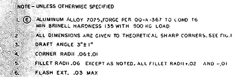

The material specified for the M4A1 upper receiver forging is 7075-T6 IAW QQ-A-367. After machining, the upper receiver is shot peened all over including the barrel nut threads. And then it is hard anodized IAW MIL-A-8625, type III, cl. 2. Seems to have performed OK over the past 2+ decades for hundreds of thousands of US military M4 carbines.
RE: A stronger alternative to 7075-t6?
Yeah, there's not much force in play on an upper receiver as the bolt locks into the rear barrel recess. If you ever have one fire out-of-battery, which is not likely but it has happened, they fail spectacularly.

As far as I know, the M4s supplied to the military still use a 7075-T6 die forging for the upper and lower receiver. The exterior of the upper receiver is shot peened after machining, then anodized, and then the bore surfaces that contact the bolt carrier are coated with DFL. One interesting thing is just how loose the RT fits are between some sliding components, such as the bolt carrier OD and upper receiver bore. Likely to permit operation at conditions of extreme temperatures and contamination, and allow for any CTE mismatch.
If you look at some of the M16/M4s that have been in service for long periods, you can see many areas of the upper/lower receiver (such as corners) where the anodize has been worn thru. You might take a look at MIL-DTL-71186 which is the model spec for the M4A1. The number of qual cycles the spec lists for the upper/lower receivers is quite low, and nowhere near what would pose a fatigue issue.

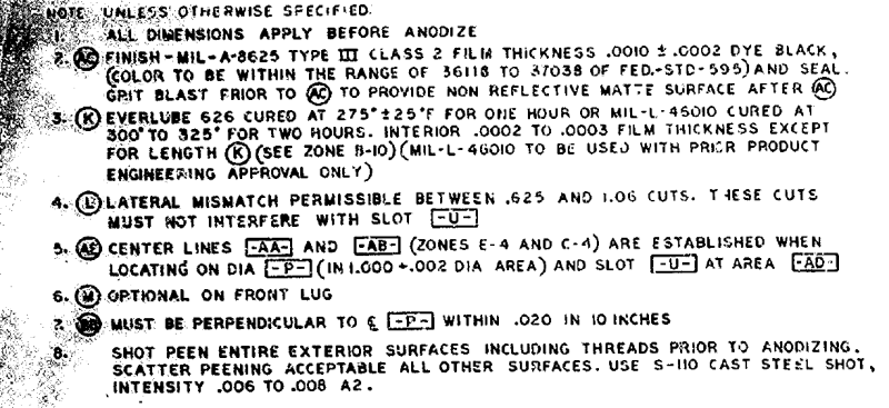

Generally speaking 7075-T6 DF parts have a pretty good fatigue endurance [and fracture toughness]. What hurts us in aerospace is EXCO/SCC failures.
I am genuinely surprised that 7075-T6 DF [or possibly forged block] is still the norm for the M-16 family of small arms after all these years of substandard performance in aerospace... especially considering it's poor resistance to EXCO, SCC, abrasion and temperature exposure.
However, 'it-is-what-it-is'. Apparently the shot peening does the trick on the exterior... and the SFL & lubricants protect the interior.

Will, I can probably help you on that last post. Every blank I've seen is a die forging. They essentially are supplied by the foundry to the machine-house as shown in the attachment. The uppers are very similar, with the interior needing bulk removal and finishing ops.
The most rudimentary application of care and maintenance will altogether prevent those types of corrosion in the field. There are undoubtedly extreme cases which have come to light, but honestly, in my opinion, corrosion of the basic receiver halves is the least of the worries on the Stoner platform.

I wonder how these newer receivers will last in the tropical/corrosive SEA climate. Apparently M4A1s have been sold in-mass to the Philippines to replace M-16s, so the real-world tropical experience will be 'telling'. Line-troops can be far-less fastidious in cleaning, oiling, and general maintenance relative to SF troops... although a healthy weapon can be the difference between living and dying.
NOTE... for what it's worth. the Forging parting plane [FPP] has been a nagging source of SCC/fatigue failure in aerospace parts... especially when machined-thru. Amazing that the FPP of the receivers hasn't caused problems. Exterior peening retards exterior crack-initiation... so exterior initiation is a low probability. However there appear to be other vulnerable points where the FPP has to be machine thru that are not peened.

The forging parting plane [die line] is where excess material is extruded-out between dies; hence beneficial surface-aligned grain-flow is re-directed toward the edge. When sectioned and etched, the adverse grain-flow toward the edge is evident.
ASME Forging Design Handbook 1972 has an excellent discussion of this phenomena.

Thanks for that Will. Very familiar with the process, we are presently using around 60,000 pieces a year of aluminum forgings at my present employer, but these are all very low criticality parts and we don't have the capability in-house to perform that level of inspection. I'll try to get my hands on the handbook.
With a typical M4 lower receiver, such as the photo I posted yesterday, there is a significant amount of the parting line machined away, with die-face surfaces remaining largely net, as-forged. The buffer tube protrusion and handgrip tang being notable exceptions.

The M4 upper/lower receivers are made from matched die forgings. I have a new Colt M4 (SAO) which is manufactured using the same materials/processing as their military M4, and the upper receiver has a "keyhole" forging mark which indicates it was produced by Cerro Fabricated Products. You can actually purchase a raw 7075-T6 flat top upper receiver forging for $23, which is incredibly cheap. FN has recently replaced Colt as the primary supplier of M4s to the US military. I'm sure they still use a matched die forging for the upper/lower receiver, but it's possible they opted to use a different alloy and/or heat treatment.
I found some old public source prints of the upper receiver forging/machining and made CAD solid models from them. Then a friend and I purchased a couple raw forgings and finish machined them. They came out very nice. Below are some pictures from the project.
https://res.cloudinary.com/engineering-com/image/upload/v1457052774/tips/FLAT_TOP_UPPER_PROJECT_iialtq.pdf
