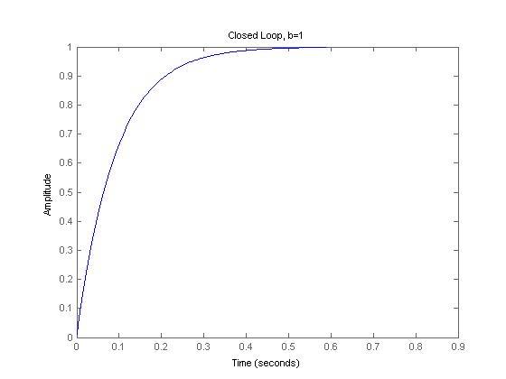

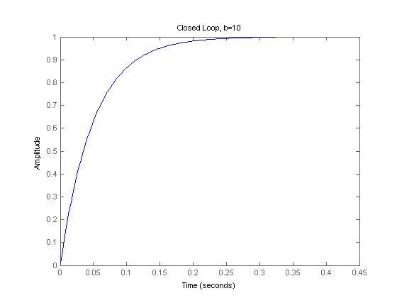

RE: DC model motor and viscous damping: behavior inconsistent?
Prelim question) The damping coefficient increasing does make the system respond faster during the open-loop transient, but reduces the gain (TF numerator) of the system so that it will spin slower by a factor of b for a given current. Look at the original differential equation Jdω/dt+ bω = KtI - damping produces torque opposing angular velocity, not angular acceleration (which is opposed by J, the moment of inertia). Compare your final open-loop plots - the second one with 1/2 the damping coefficient has twice the dc gain, but takes twice as long to reach steady state. Alternatively, you could think of it this way: if there is 1/2 the damping coefficient, it will require 1/2 the current to achieve the same steady-state angular velocity but it will take twice as long to reach steady state. One last argument here: if you multiply both sides of the original differential equation producing the TF by angular velocity, you have Pload+Ploss due to damping=Pin. Therefore, an increase in damping coefficient also reduces the efficiency of the system due to the loss term increasing. Maybe that's why you're thinking the response should be slower, but it isn't, for the reason described above. (I'm not really sure I've made a clear and convincing argument with this paragraph.)
3) One of the effects of negative feedback is that it reduces the sensitivity of the closed-loop transfer function to system parameter variation. You've just seen that effect using your closed loop simulations by realizing the outputs are essentially the same even with a factor of 2 difference in your damping coefficient. The closed-loop TF is given by KKt/[Js + (b+KKt)]. The product of proportional controller gain K and motor gain Kt is high by comparison with b (10 vs 1e-5 or 0.5e-5) and dominates their sum in the denominator - meaning the closed-loop pole locations for both values of b are basically the same, and the DC gain is KKt/[(b+KKt)], essentially 1. Hence, you get (approximately) the same step response. If the product of KKt was closer to the value of b, changes in b would have more of an effect on the closed-loop response speed and steady-state gain.

Regarding 3), say I change b by a factor 10 to make its impact visible on feedback.
b=1 now, so Transfer Function TF = 10 / (s + 1)

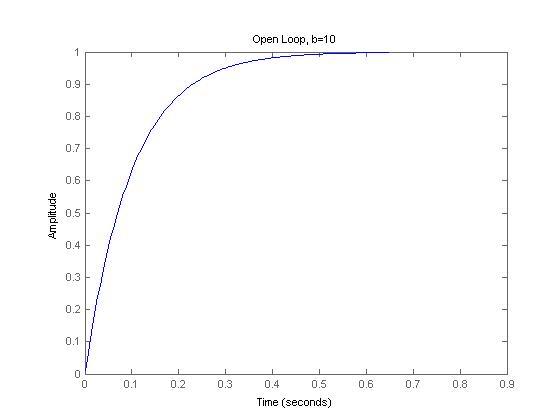

Here are the open- and closed-loop step responses, with a simple closed-loop feedback gain of 1. For closed-loop, the step input is scaled by the inverse CL-TF@s=0: ( 1/[Kt / (b+Kt)] ), to give the same final target value of 1 for both the b=1 and b=10 case for easier comparison. (See Matlab code at end of post)
b = 10, so Transfer Function TF = 10 / (s + 10)
Unexpectedly, after scaling the step input so that both reach 1, the closed-loop risetime is longer for the lower damping case. Why is the risetime faster with higher b?
If there is no input step scaling -- that is, just keep StepAmplitude=1 -- then the closed-loop ristime of the b=1 case is indeed faster than the b=10 case, but the outputs would settle at different values: 0.91 for b=1, 0.5 for b=10. If steady-state tracking to a specific output value (eg =1) is needed, then the input scaling seems to be required, but that also causes the behavior to be opposite what's expected, as above...
I see that the SS outputs are 0.91 and 0.5 because the Closed-Loop TFs are 10/s+11 which is 0.91 when s=0 (steady-state), and 10/s+20, which is 0.5 when s=0 (steady-state), but it's not clear how to compare results, then, without input scaling...which seems to flip the behavior
