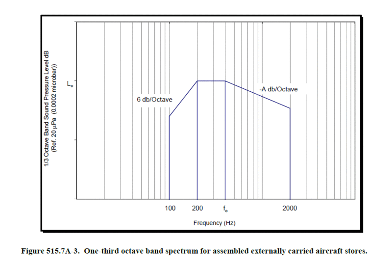

I would take a page from military vibration or acoustic noise specifications, which often have the entire power spectral density, which would seem to be what you need to go after, particularly in the ranges where your structure or equipment are especially sensitive. Like:
So, in your case, you'd notch out the frequencies that are resonant.

The go-to approach for things like that is to either envelope the range of frequencies or to insert the notch with a narrative description of what is not allowed, e.g, "There shall be no a single frequency which exceeds 15 dB above the background ambient"

I think that still can be handled. The broadband specification is a PSD, which means that it assumes that the frequencies are random and non-stationary. So you can still do the PSD curve, but with a similar caveat, "There shall be no frequency that is more than -XX dB below the ambient for longer than yy seconds."
This can be verified by averaging a series of spectrum analyzer scans. The random frequencies will average down, but any fixed frequency will stay put.
Or, something like, "When unit audio noise is averaged over xx seconds, there shall be no frequencies that exceed the average more than yy dB."
