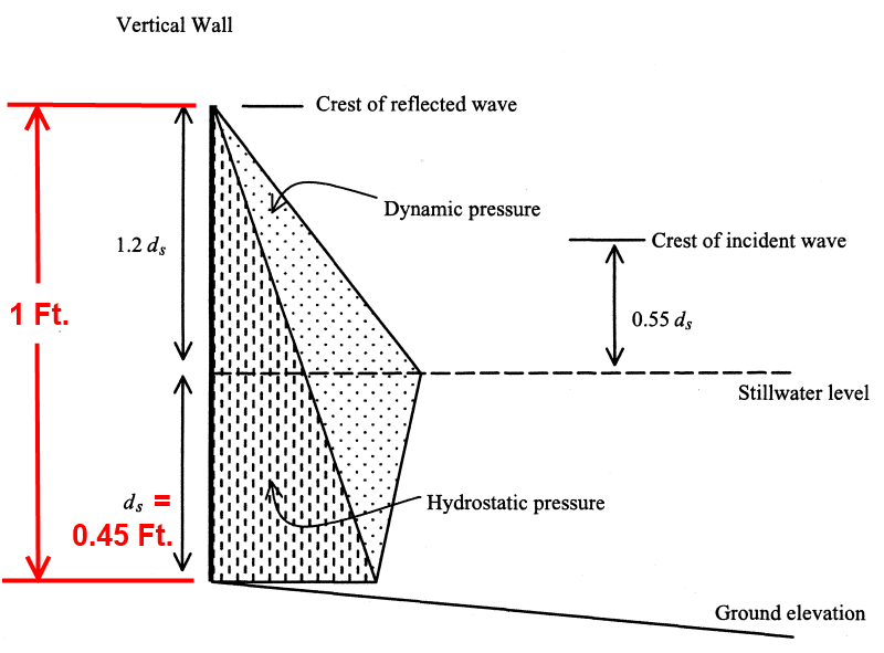

Haydenwse - IMHO, it is time to take a semi-graphical look at this problem. ASCE 7-10 appears to assume that the still water depth (ds) plus the height of the reflected wave (1.2 ds) is always less than the height of the wall. That is not true for this problem.
The wall is 1 foot high, with backfill.
From the diagram below, the worst case breaking wave loading will occur when ds is 0.45 feet above the base of the wall. If ds is higher, the waves just wash over the top without exerting any force on the wall. If ds is lower, the crest of the reflected wave does not reach the top of the wall.
Using Cp = 1.6 (Risk Category I), Unit Weight of Sea Water = 64 pcf, and solving the equations (5.4-5) and (5.4-6), I get:
Pmax = 81 lb / ft2
Ft = 54 lb / ft

I would like to make sure I understand the application of equation 5.4-5 and 5.4-6. It appears that both are describing the same force. Pmax sets the max point of the pressure and Ft is the resultant of that pressure diagram. It seems to me that Pmax is just given to show how Ft was derived and that the pressure and force are not additive.
If this is correct than you just need to apply the 54 plf load at the Stillwater height.
If they are additive than the wall would be designed for 2*54 plf
RE: Bulkhead in flood zone V
Haydenwse - Figure 5.4-1 is a simplification of a breaking wave, but a pretty good one. The two equations give accurate results based on the assumptions.
Pmax (lb/ft2) and Ft (lb/ft) both have to be considered individually to design the wall. This 1 foot high wall could be somewhat confusing since it is so short; not much pressure or force.
It may help to consider at more typical height wall, say 6 feet. Then, ds = 2.73 feet. From this I get:
Pmax = 490 lb/ft2
Ft = 1984 lb/ft
With these numbers, it may be clearer that designing a wall for a pressure of 490 lb/ft2 is different than designing a 6' high wall for a total force of 1984 lb/ft. The wall has to meet both of these criteria.
