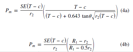

What I have learned now is that the vendor performed the B31.3 calculations 304.2.3 using the depth of the weld as the pipe wall thickness.
However there is no SIF (assuming you mean stress intensification factor) in the equations. Or would this be the quality factor "E" from Table A1-B?
Here is my spreadsheet calculator I threw together to run the calcs. Not sure how to incorporate a "SIF"
From my results it looks like a partial penetration weld of 75% of the pipe wall (nominal 0.375", so 75% is 0.281" thick) is the minimum thickness required to meet the design pressure (175psi). Does that seem correct?

In either case, this has nothing to do with what is being proposed as some kind of knock down factor for inadequate penetration for miter. Second, you can't mix and match Piping Codes. If SIF is not addressed in B31.3, it is not addressed.

Thanks metengr. I will ignore SIF. I did not see it anywhere in B31.3 either.
I am planning to allow the vendor to proceed with the partial penetration weld, but incorporating NDE (UT) spot checks during fabrication to ensure we are achieving the required weld depth of (0.281") or 75% of pipe wall thickness. This seems to satisfy B31.3. Would you agree?
