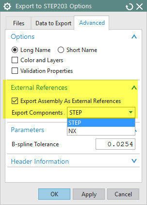

On the STEP export dialog, go to the "Advanced" tab and tick on the "Export Assembly as External References" and then set the export components as STEP (See image below).
This will then export a separate STEP file for each component, if you select the entire assembly.

Perfect, that's what I was looking for. Thank you PhoeNX.
