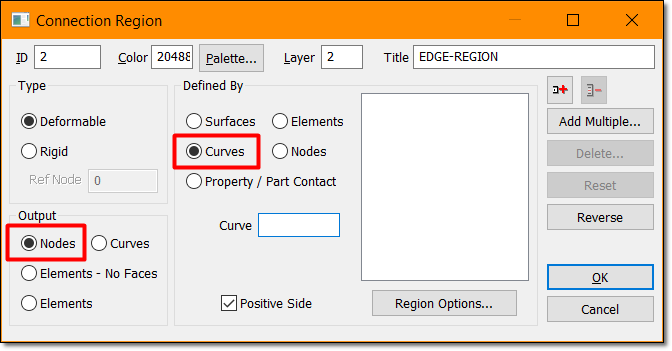

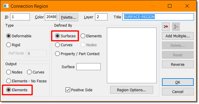

You need to define a GLUE edge-to-face connectior with two regions: one EDGE region (the SOURCE) and other the SURFACE region (the target).
• The source EDGE region should be defined by PICKING THE CURVE(S), and selecting NODES as ouput. Edge regions are edges of the shell elements CTRIA3, CTRIA6, CTRIAR, CQUAD4, CQUAD8,and CQUADR.
• The TARGET SURFACE region should be defined picking surfaces in the screen, and as OUTPUT select ELEMENTS (this is the default option). Surface regions are the faces of the shell elements CTRIA3, CTRIA6, CTRIAR, CQUAD4, CQUAD8, CQUADR and the faces of the solid elements CHEXA, CPENTA, CPYRAM, and CTETRA.
Next define the CONNECTOR with care: the TARGET region should be the surface region, and the SOURCE region should be the EDGE region.
And define the GLUE property: click in defaults to enter the correct options, the important one is the separation (distance) between SOURCE & TARGET regions.
And you are done, please note that miracles don't exist, do not use a GLUE contact where a high stress gradient exist, use it in zones of the model where the response is costant, OK?.

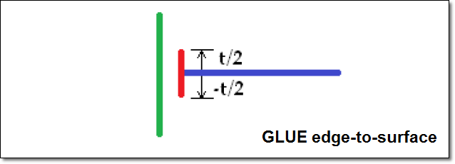

A simplistic description of edge-to-surface glue is that the software creates pseudo-faces along the edges in the source region. It then connects these pseudo-faces to the shell or solid faces in the target region with weld like connections. From the glue points on the source side pseudo-face, the software projects a normal in the outward normal direction. In addition, the software searches a small distance in the inward normal direction in order to glue edges and surfaces that may interfere due to meshing irregularities.
A glue connection occurs when the following is satisfied.
A. When a projected normal hits the face on the target side.
B. The distance between the two is equal to or less than the search distance which you specify for the glue pair on the BGSET entry.
For example, the green line below represents shell or solid free faces in a target region, the blue line represents shell elements, and the red line represents an internally created pseudo-face along the
edges in the source region. The pseudo-face can be visualized by extruding the element edge from -t/2 to +t/2 in the parent shell element normal direction.

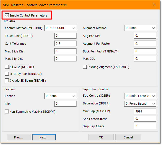

In fact, not a rmor, is real!!. Starting from FEMAP V11.2 (March 2015) it was added the MSC Nastran Contact Solver Parameters dialog box to Analysis Set Manager for Static analysis.
The MSC Nastran Contact Solver Parameters dialog box contains a number of options which can be specified when performing an analysis in MSC Nastran, which also includes surface-to-surface contact. All of the items in this dialog box correspond to items (Params) which can be included on the BCPARA entry. For more information, see the BCPARA (Contact Parameters - SOLs 101 and 400) entry in the MSC Nastran Quick Reference Guide.
You must check the “Enable Contact Parameters” box for FEMAP to use any options in this dialog box:

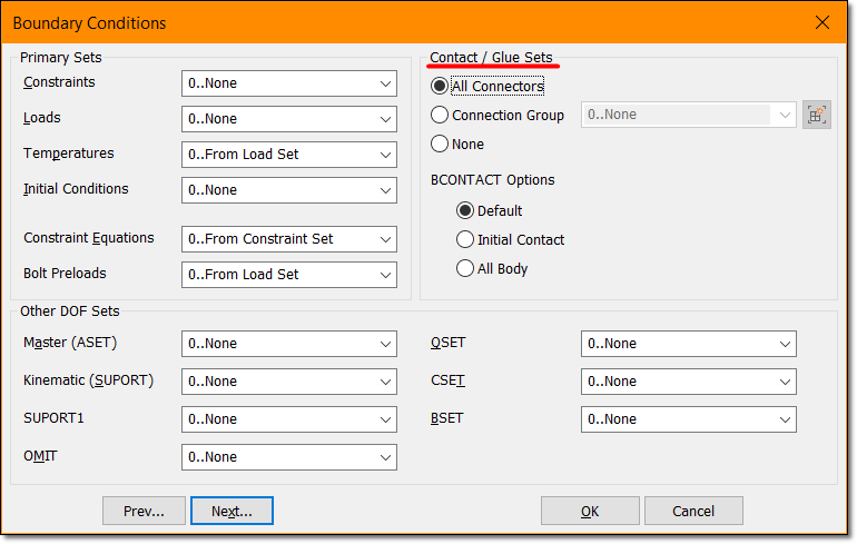

Also Added Contact/Glue Sets section to Boundary Conditions dialog box:
