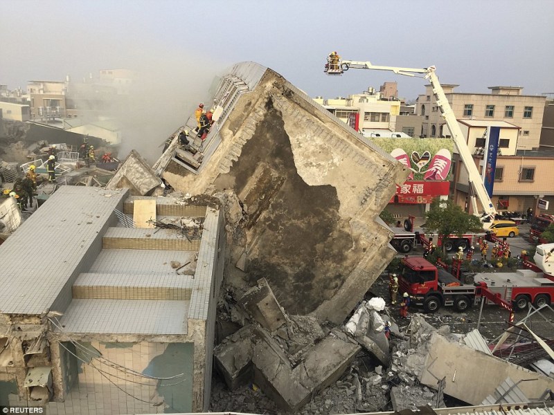

Is it just me or shouldn't there be some kind of rebar sticking out of the bottom of this building which is laying sideways?
very odd don't you think...
RE: 17 Story Building in Taiwan Collapses post 6.4 magnitude earthquake
Isn't the rebar just the cross-floor stuff for that particular floor?
I'm amazed how most of the building stayed.... assembled.
Hard to tell from the picture, but it appears that the picture shows the building roof.

BBC reports that the building's concrete was "reinforced" (not exactly the correct word) with tin cans and styrofoam. Visible at a place where it cracked.
http://www.bbc.com/news/world-asia-35515749
Perhaps it was not a load bearing wall.
Holy crap, the sheer amount of space taken up by those cans and styrofoam is astonishing! How the weight of the building itself didn't cause those walls to collapse is surprising.

Don't believe the failure of a deck slab resulted in the building rotating over. A failure of a floor slab would have caused the floor to drop vertically.
Most likely there was a failure associated with the vertical columns.
"The structural system of the building was pretty poor," said Sheen Mau-song, a professor of civil engineering and member of the Taiwan Civil Engineering Association who is part of the government's team investigating the collapse.
"There were very few pillars on the first floor, the pillars were quite scattered about, and the materials, from the weakest side, were destroyed."

I don't often deal in seismic, however, this looks like a case of "Soft First Story" behavior?
The picture provided by bimr at 02:10 looks like the stories above are displacing in a separate direction from the first...
Yes the first floor has that stilty look to it.

This building fell like a tree cut with an axe. Either most of the first floor columns collapsed or ground liquefied. There was a massive failure of some sort, not just a few columns.
Soil liquefaction has been identified as a problem in previous earthquakes. The government said it will soon make public a list of areas potentially vulnerable to soil liquefaction in a first step to address the problem that may have contributed to the collapse or subsidence of several buildings in the Feb. 6 earthquake.
