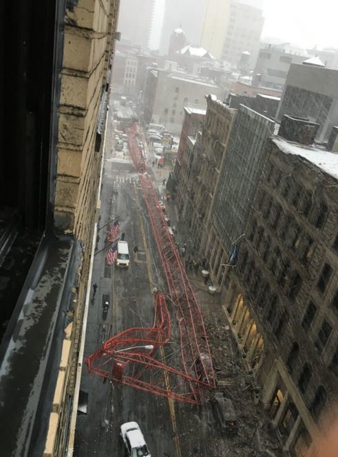

Video of the collapse from the 30th floor of an adjacent building:
http://www.nytimes.com/2016/02/06/nyregion/crane-c...
Gothamist appears to be actively updating as information comes in:
http://gothamist.com/2016/02/05/crane_collapse_tri...
Quote (Gothamist article)
None of the victims were workers connected to the crane, which is owned by the Bay Crane company. Four buildings were damaged, including New York Law School on West Broadway. The crane's fall impacted gas mains, and officials say there are gas leaks in the area. Several buildings have been evacuated, but none of them were residential.
Workers were in the process of lowering and securing the 565-feet-tall crane this morning before it was toppled over by 25 mph winds. "The crew was directing people away from Worth St. as the crane was being lowered," according to de Blasio.
The crane was inspected by the Buildings Department yesterday because the company had requested permission to extend it to its current 565 feet height. There are some 376 of this type of crane, called a "crawler crane," in use throughout the NYC, and de Blasio has ordered all of them to be lowered and secured in the wake of today's incident. 76 taller "tower cranes" have also been ordered secured.
The crane operator is being interviewed by the NYPD, but it's currently unclear if any criminality is suspected.
RE: Crane collapse in NYC
Seems to me the operator kept the boom mainly in the roadway, minimizing the damage to the four buildings. It also appeared to happen very slowly...
As it was snowing, I wonder if icing could have been a factor, increasing the wind force and overturning ice load?...
This could have been a lot worse...

BridgeEI - There is a distinct angle in the boom where the "luffing jib" meets the main boom. That is intentional.
I believe the crane is a Liebherr LR 1300...
News reports state the crane is rated 330 tons, the boom length in use is 565 ft. Those numbers are an exact match for the Liebherr LR 1300.
The company that owns the crane, Bay Crane, has at least four of this model: Link
The photo above is a "spitting image" of this model:
Based on the specs for the Liebherr LR1300 (see link below), handling 565 ft. of boom, the absolute maximum allowed, would be a real challenge even under ideal condition, which was not the case this morning.

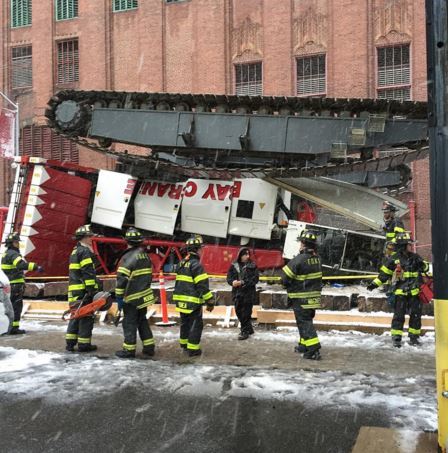

Strikingly similar to the dale in Mecca. These cranes are great, but rely on having a load or being tied down. Once they get close to vertical you loose all control and high winds will basically blow it backwards and there's nothing to stop it once it starts.
www.eng-tips.com/viewthread.cfm?qid=394730
But in this case wasn't the boom being lowered and then took off down? Seems like a mechanical failing like a brake couldn't hold it. The relatively slow descent looked sort of like a slipping brake (that keening sound) that couldn't hold but did slow the boom until the crawler tipped. Once the crawler started over the brake could actually hold since the torque load suddenly reduced.
I'm amazed the driver wasn't squished.
Keith Cress
Sorry, i want able to view the video until now. Looks like a failure or error in the lowering procedure and maybe the extra weight of any snow or ice made the difference. The fact the base unit turned over tells you the brakes were working but clearly not enough counter weight to stop the decent

I'm thinking that the jib should have been luffed or lowered first. There appears to be a large wheel or wheels at the end of the jib.
These are common on large cranes of this type.
As these cranes are errected, the main boom is lifted first and the end of the jib is allowed to roll along the ground. When the main boom is near vertical, the jib may then be safely raised.
I susspect that they did not intend to lower the crane all the way to the ground.
They may have been intending to only lower it enough that there was no danger of the wind blowing it over backwards, as in Mecca.
That would explain lowering it with the jib in the working position.
A combination of ice build-up, the extended jib and gusting wind may have moved the center of gravity out past the end of the tracks.
Once the crane starts to fall, the radius of the boom CG increases and continues to increase and the radius of the CG of the crawler part complete with counter weights decreases and continues to decrease. From that point, there is no going back.
