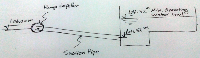

I am reviewing a design of water pump station which is fed by an open tank. from the hydraulic point of view, will there be any problem if the impeller level was higher than the tank intake level, although the NPSHr is satisfied and the minimum water level in tank is still higher than the impeller level by 1.5m?, in other words, the suction pipe is going upwards.

Theoretically, there is no concern. But my concern has been because I have never seen such case before.

I agree with the comments above, there should not be any problems because of the elevated suction nozzle.
With only 1.5 meters of cover, it is possible that, at minimum pumping level, you could experience suction vortices.
These are somewhat common with Cooling Tower Water pumps

You may have to consider a baffle in the final design

Agree its not a problem, but sounds to me like a waste of money if the tank minimum level is at least 1.5m plus whatever level the pump is above the base of the tank.
I'm a little confused by what you mean by "higher than the tank intake level" Do you mean nozzle?
A simple sketch always helps in these circumstances.

Following sketch shows what I mean.
Nozzle level = 104.51m
Impeller level = 106.00m
Minimum operating water level in tank = 107.52m
What I mean by 1.5m, is the deference between impeller level and minimum operating water level (107.52-106=1.52m)
Nozzle submergence is checked in accordance with ANSI/HI 9.8-1998 and found enough (no vortex problems), =107.52-104.51=3.00m

Without the complete scheme including heights and velocities, it is hard to say. It may work. Pump suction lines should be as short as is practically feasible. Round suction source vessels can be problematic with regard to vortex formation. A pipe entering the tank from a higher level allow the liquid to free-fall and impact on the suction reservoir’s liquid surface can aerate the vessel’s contents causing pump problems.

No problem hydraulically, just remember a sump type system will collect solid matter faster and you need to have access to it.
