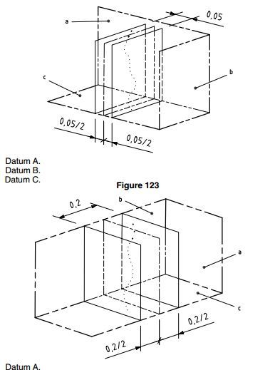

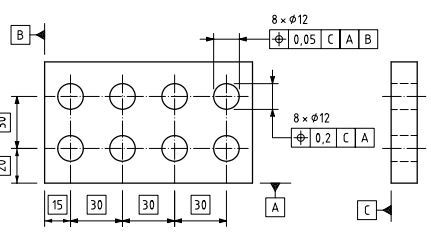

The question I have is regarding the datum setup and the interpretation of tolerance zones established by them for bi-directional position tolerance frame setup. Attached is the illustrations from ISO 1101:2004 version of standards. ASME seems to have the same interpretation in regards to bi-directional position tolerances.
Typically at my company we use positional tolerance in it's full capacity with a diametrical symbol for a cylindrical tolerance zone when applicable for a cylindrical feature of size but it's eating me up not being able to fully grasp what seems to be a simple answer that I'm missing for this scenario.
Most of the examples I see have 3 datums setup for bi-directional. I understand the tolerance frame setup for cylindrical tolerance zones and 3 datums in both bi-direction..but it seems that using only 2 datums for one of the directions is interpreted the same according to the tolerance zone definition so I'm a bit confused. Is 3 datums necessary when 2 theoretically seem that they would do where one controls the orientation and the other the location with respect to the referenced datum? Or like some orientation tolerances, is the first 2 for establishing the tolerance zone and its orientation with respect to the 2nd datum and the 3rd locates it?

Think of your datum reference frame as order of fixturing: lay the part on [C] first, lean against [A] second and against {B} last.
Should you lean against [B] first, your results may be different.
Or, leaning against [A] to take measurement from {A} and then leaning against [B] to take measurement from [B] will bring different result from fixturing against [C|A|B], and THEN taking measurements from [A] and [B]
Confusing?

No, what you stated makes perfect sense.
I understand the sequence of datums, just had my mind in overdrive and overlooked that very point you made

One more additional question to the top scenario...
A lot other examples I see have datum B to the one control lacking it; how does this change or add anything different that already isn't being controlled with C & A?
I can't see that theoretically serving any purpose as the median line in the direction the dimension is addressing wouldn't gain anything from banking up against a datum B simulator since it isn't controlling location with respect to datum B in that scenario.

On the picture shown on your OP imagine part sliding along [A]. Measurement from [A] will still the same, [B] is not relevant, as we don't measure from [B].
From degrees of freedom point of view, part is not fully constrained, but it still possible to measure.
