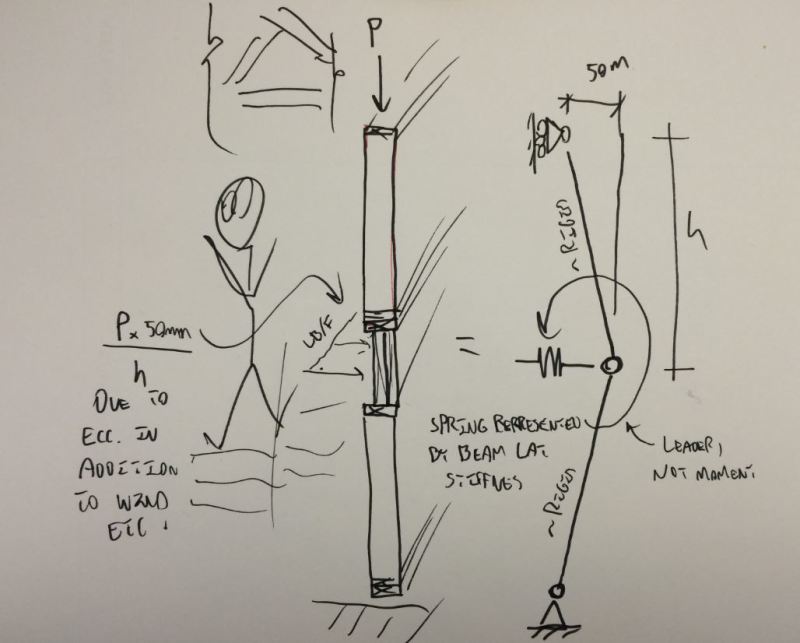

RE: Gable Wall with Stairway
Quote (medeek)
If I'm going to go the platform framed method I also really like adding an additional rim board or LVL (as I have drawn in the very top picture above) that is spaced so that it is flush with the interior wall. This eliminates the eccentricity described by KootK and also provides a cavity for insulation and electrical.
1) I like the double rim board as a composite member if possible. It's stiffer that way. If you're going to separate the plies, you'll either need to treat them as two individual bending members (more deflection) or find some way to stitch them back together intermittently.
2) This method doesn't eliminate the eccentricity I had in mind. The sketch below shows what I was getting at originally. It was overly optimistic not to include it in the first place.
If the plies are separated doesn't that give the whole assembly more section modulus? Solid blocking between the plies 24" or 32" o/c should help to further stiffen things up. I will post a detail shortly.
Two separate, independent plies would be twice as stiff as a single ply. However, two plies snug and composite would be eight times as stiff as a single ply. Two plies separated by a gap but made to act compositely would be better still. The trick is making the separated plies behave compositely. Blocking would be one way. Another would be using the plates above and below to stitch the plies together into a box beam. You'd probably be stuck with toe nailing on the bottom though. Nobody loves toe nailing.
Upon further inspection, I see that you've already thought of the plates as the webs of the box beam.

I probably should have checked the numbers first. Given the high wind loads in our area (155 mph ult.) a 3-1/2 x 9-1/2 PSL loaded in the weak axis will deflect almost a full inch with a clear span of 10'-10" and a trib. length of 9'. However, a 5-1/4" beam will pass with flying colors, so I've updated my detail to:
The eccentricity is small enough that I think it makes sense to just sandwich them together and make sure they act as one unit. I still like the idea of disallowing any splices in the members in this region of the wall and will keep my notes specifying that.
