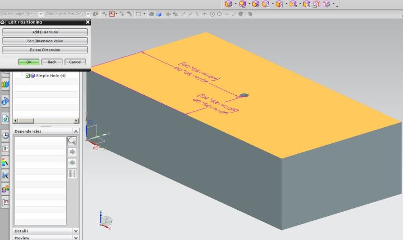

Dear Forum,
I am working with the NXOpen RegisterRpoRoutine method and trying to create hole constraints programmatically. I've tried several examples within the GTAC solutions and can't seem to get this functionality to work. I am developing in vb.net. I've created a function that creates a block with a hole. The code is attached below.
Thank you for your inputs.

RE: Looking for Help NXOpen - RegisterRpoRoutine
Okay. I have the rpo code working. The revised code is shown below. However, the constraining dimensions are coming in upside down and backwards. See attached image.
Ignore my last statement about the dimensions coming in backwards. They are fine. I was just looking at the model upside down smile Everything is working well. It was difficult working with the GTAC code examples for rpo dimensioning of features like holes and slots. It is just one of those coding practices that have to be learned...not very obviously.
