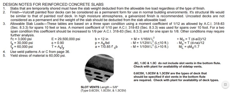

Recently I was asked to justify some load tables that can be found in manufacturer’s deck catalogs. In particular the client was requesting information in regards to the capacities of non composite deck (from deck). In digging through the various catalogs I have pretty much been able to recreate the tables (within a few psf). However, in order to generate the slab capacities shown in the catalogs I have to ignore the first bay which tends to have higher moments. They are using moment coefficients of 1/12 WL^2 for negative moments and 1/16Wl^2 for positive moments. From what I can tell the first bay should be subjected to a positive moment of 1/11Wl^2.
Has anyone noticed this and can anyone justify ignoring the first bay in their analysis? This just doesn’t happened across one mfr, but at least two so far and it may have something to do with the SDI which I don’t have.

My understanding is that the load capacity for 3-span deck is based on the two end spans, not the middle span.
If I'm taking a deck to near max capacity (for 3-span) I usually comb through the plans and try to figure out if there is a condition that would force a 2-span or single-span condition and be sure the deck still works.

That's now how the tables I have reviewed from two different manufacturers are calculated. They both ignore the end spans.
I usually don't push the deck to capacity as I know the placement of the reinforcing is never the best. In this instance I needed to verify how the charts were created so I could adjust some capacities. I was surprised how they ignored the end span condition.

Just popped open my Vulcraft catalog and it seems like you're right. They just blanket the 1/16 factor for all positive moment capacities.
Of course they give themselves a nice CYA note:
Other conditions may require further analysis.
