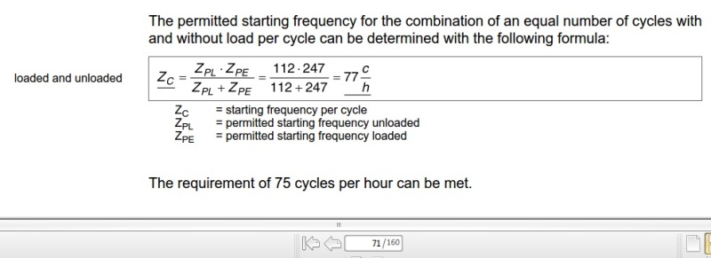

Now I have dedicated some time on reading other literature from SEW, watched various lectures on youtube on similar topics, googled for other examples from other manufacturers, and a lot has became clearer now. Anyhow, some answers I didn't find. This is one of them:
In the document I have mentioned previously - “Project planning for drives”:
download.sew-eurodrive.com/download/pdf/10522913.pdf
Page 71 - there is an explanation how to calculate the appropriate starting frequency of the motor in behalf of ratio loaded/unloaded cycles:
In this example, it is allowed to start the motor 112 cycles/hour in loaded condition, and 247 c/h in unloaded. In my opinion, if this motor would work in the mixed load (sometimes loaded, sometimes not) then the permitted starting frequency would be somewhere in between. But according to this calculation (and all the other examples in this manual from SEW) this formula is present, which represents a lower number of mixed condition starts than the fully loaded condition starts. How can this be explained from physical point of view? Because now it means that the motor can be started 112 times in fully loaded condition, but only 76 times fully loaded + 1 time unloaded. I don't understand this, how can it be?

I worked on contract for a few months for SEW and got to know these calculations intimately. But it's been a long time. With the "planning" document, you're as good as you can get. The German approach is very rigorous. Admirable in some ways.
That calculation is about "starts per hour" and is all about heat dissipation. In order to ...ahem....optimally...size the motor for an energy-sensitive location such as Germany and NOT like the US (...yet, anyway), then these "starts per hour" must be analyzed. Take your best shot. If your best shot is no good, simply solve the problem by upsizing the physical size of the motor so that the bigger mass will handle the multiple starts per hour (which, essentially, is a short circuit and therefore creates a bit of heat that must be dissipated).
Some years after my stint at SEW I had the opportunity to do a gearmotor sizing exercise. I chose Dodge as the supplier. American. Murcan. Much more brute force unsophisticated get-it-done type of calculation. That's when I discerned the truth about an alternative path to going home on time. Upsize that b*tch and call it a day: it's just torque, and the bigger motor will last forever because it never overheats.

tygerdawg , thank you for your input. To add up, I would say - shame for SEW, this document should had been improved so much since it is 15 (fifteen !!) years old, it has lots of mistakes, haziness, and some of motors in the examples do not exist any more...
Anyhow, I completely understand the number of motor starts equals to short circuit in the winding, dissipating more heat. What I don't get is - how can it be that you can start a motor 112 times per hour fully loaded, but only 77 times in mixed mode (say 50 loaded ant 27 unloaded). How can these 27 no-load starts be equivalent to 112-50=62 loaded starts?
Again - 27 no-load starts will give the same amount of heat like 62 loaded starts IF motor is started in mixed mode
BUT - if there is only no-load starts, then it can be as much as 247
I say this might be a mistake, but the same formula is in so many examples ...
