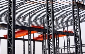

Quote (OP)
1) I'm not sure, given the restraints on the columns, that a k value of 2.0 is appropriate? Even if not, yes, very far.
Sounds more like K=1.0 now that I understand it better.
Quote (Op)
What do you mean by the trussed column resembling a buttress?
See the first pic below. Imagine some more webbing in there. This would be more suitable for the cantilever that I had envisioned. See the second pic below for something closer to your situation. There are really oodles of options for a built of column of course.
