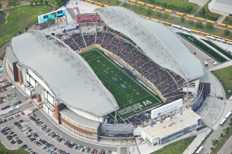

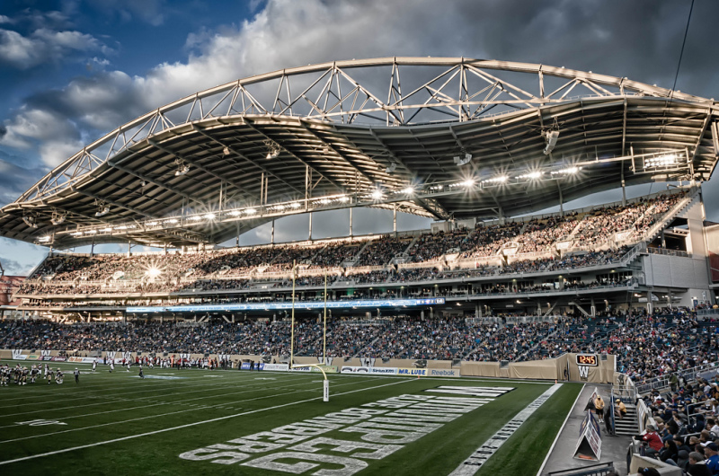

It's likely too late, but check out Investor's group field in Winnipeg for an idea to get the column free area over the stands. There's a massive arch truss that the canopy hangs from, super cool.

Feather in the cap for Walter P. Moore. Damn Yankees stealing our cool work... We'll just see about that now that the loonie's worthless.
