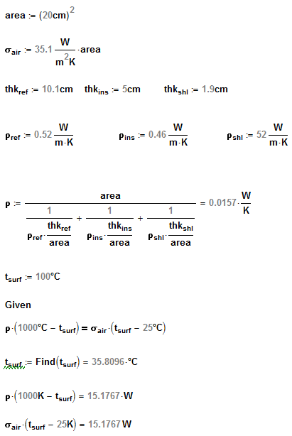

RE: Heat Transfer between 3 plates of different materials
In any case, the surface temperature seems high; I get more like 36ºC
But...how did you do it?
@ IRstuff
It is not supposed that R by conduction = (e1/k1 + e2/k2 + e3/k3)1/A = 1/R = A / (e1/k1 + e2/k2 + e3/k3) and it is more like = 0.13 W/K so adding the R by convection it would be like 0.11 W/K. So the Q of the system ´d be 116 W and the temperatura of the cold face its more like 108°C So...there is something that I dont get...and also how do I choose a correct convective heat coefficient for air taking into account air speed

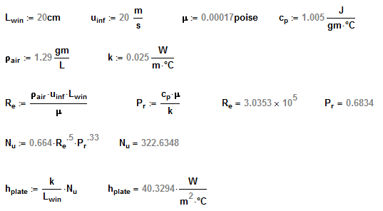

The convection coefficient is dependent on air speed and geometry. There are tables and graphs on the web: http://www.engineeringtoolbox.com/convective-heat-... so 35 W/m^2-K was pretty much the value for 20 m/s, but that, I think, is specifically for a flat plate.
http://www.cheresources.com/content/articles/heat-... but there are other correlations that have been developed: http://www.pathways.cu.edu.eg/ec/text-pdf/part%20b...
For the length of your plate, the equation from the first citation results in 40W/m^2-K
