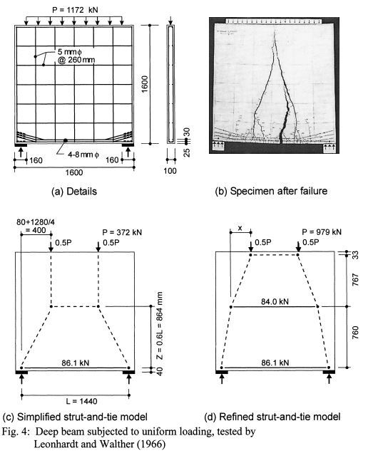

@SteynvW: I found something in print. See the clip below. Everyone prefers a reference over some stranger's advice, right?

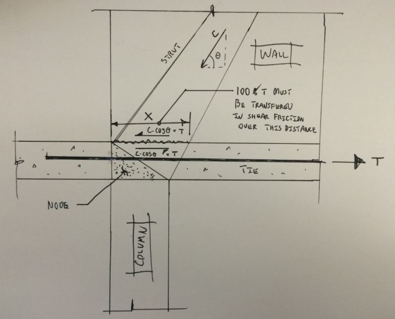

And how is the whole connection going to work with the tension tie above the top of the slab?
I did suggest that there should be a downturn which would have the compression strut coming into the side of the column! There is no way I would detail it as you have shown. Why, because it feels better to me. But that is just my opinion.

As shown below for the gravity case. If you envision the bit of slab sandwiched above the column as simply an extension of the column, the detail become that of any simple span, column supported deep beam.
Quote (rapt)
Sure. And the preference that I've expressed here is simply my opinion. I believe that both details can be made to work and, in truth, my preference for placing the tie in the wall is slight. Certainly, placing the tie in slab facilitates a very appealing tie anchorage scenario.
No matter which approach is selected, the diagonal compression force needs to be "turned" vertical before it passes into the column. As a matter of general philosophy, I find it preferable to affect that change prior to the strut crossing the cold joint. One less thing to worry about in my estimation. I, like many other engineers, have reservations regarding shear friction. And, as the application gets more critical and veers further from the simple mechanisms tested, the more reservations I have.

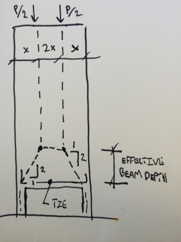

I caluclated the forces and required reinforcing according to our code using your proposed strut and tie layout.
(Please see attached). The first one is with a 2/1 ratio and the second one is
with a 3/1 ratio. The increase in angle has significant influence on the tension
reaction in the strut and tie model.
1. Is it fair to use a 3/1 ratio or even a 4/1 ratio considering my wall is 16 stories high and will in actual fact increase ration if the wall height increases?
2. The transfer from compression to tension has to be done through shear at the node, is the shear just in the marked area at the bottom of the pdf or is it continuous through
out the bottom of the wall?
RE: Shear Wall Transfer Beam
1) I don't recommend it as I don't believe that the local, disturbed region mechanics would change in response to additional wall height beyond a certain minimum. You should be able to test this with your FEM model if you care to. Adding or deletting a couple of stories should alter the magnitude of tensile stresses at the bottom of the wall but not the height of the wall over which those stresses occur.
The 2:1 is based on research and shows up a few places in various standards which gives it some credibililty in my opinion. And this is a situation where I wouldn't skimp on reinforcing. 7000 mm^2 seems reasonable to me. Assuming a single mat in the wall, I might install 12-30M at 100 in a band at the bottom of the wall. It's a fairly narrow wall for the application and getting good concrete compaction aroumd the bars will be critical.
2) Refering to my sketch, all you need to do for shear transfer is develop the tie bars to the left of where they first pass into the strut. You'll have nearly four feet to develop the bars here which should be plenty.

I put together a quick calc to test shear friction across the cold joint were you to put your tie in the slab rather than the bottom of the wall. According to my estimate, the joint would be considerably over stressed. And my calculation was based on the maximum permissible shear stress, regardless of the amount of reinforcing crossing the joint. In this instance, I feel that this supports my preference for installing the tie rebar above the slab/wall cold joint.
22.9 applies to all concrete though, even monolithic - so aren't you going to get the same overstress/result even when placed above the slab?
Ignoring the above - I don't see any problem with placing it above the slab in the base of the wall and tend to agree on it's merits. I also agree that this is no place to skimp on steel. Even if you placed the required steel in the base of wall and then placed that same amount distributed in the slab (i.e. 2x the required) you're not talking about a lot of steel.

Quote (Bookowski)
Exactly right. It would be better but not good enough. I don't believe it for a second but that's how it's presented in the code.
