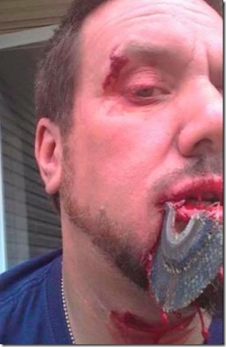

It is probably worth the effort to conduct a more thorough analysis of grinding wheel failure modes.
RE: Bursting speed of a flywheel
Bloody hell! He wouldn't even have noticed if it was steel,he'd be looking for the other third of his head though.
That's one for our next safety briefing.
