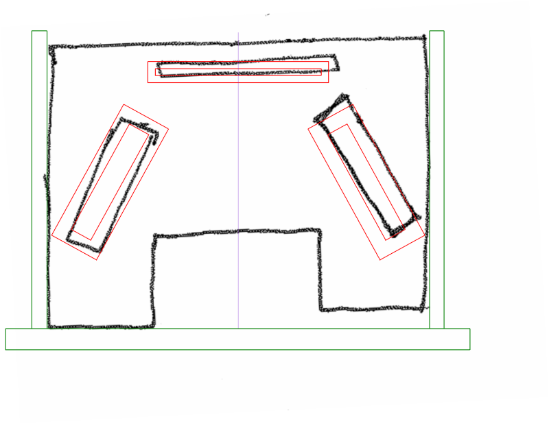

I am pretty new to the applications of GDT. I have been reading books and such to learn at my new job, but one thing hard for me to comprehend has been how to use the MMB that follows a datum in a FCF when that datum is a plane or midplane. For example, attached is a more basic representation of a part I am working with (apologizes for the crudeness but hopefully it gets the point across). The slots have a profile tolerance associated with them that call them back to datum A, B and C; however, B has an MMB modifier associated with it. I am not sure how to apply this to the slots' tolerance. I understand that it does not give bonus tolerance to the .005 but I'm not sure where it comes into play especially when datum B is a mid plane. Does its size really change even when the width increases or decreases? And if so, how does it affect the slots? I guess it is some kind of shift but I'm just not sure how you would apply it.
please let me know if you require any more information.
Thanks.

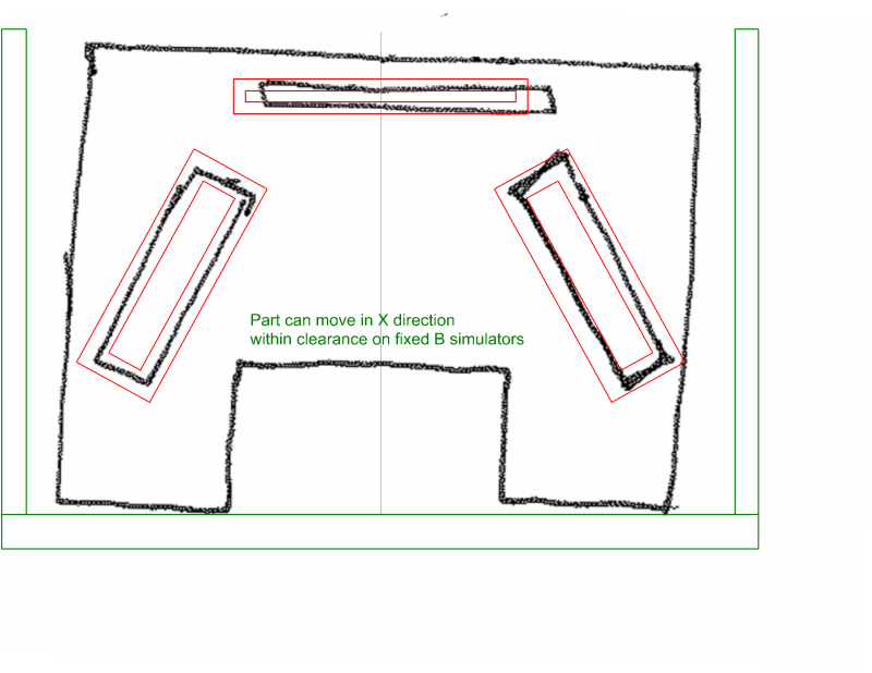

You're right that the MMB reference on B doesn't make the profile tolerances zones any larger. It makes the datum feature simulator for B a fixed width, which allows "datum feature shift" if feature B is produced smaller than its maximum. The shift can be used to try to get all of the slots to line up with their tolerance zones (which are fixed relative to the datums). But by default they all have to line up at the same time - you can't shift one way for one zone and shift a different way for the others. Hope this helps.

1. if the MMB on datum B was not there, the the datum feature simulator or gage would just have to clamp down on the width of B?
2. With what you have drawn above, the part can shift to try to fit the slot features, but can it shift away from Datum C (the wall perpendicular to the 2 walls for datum B)?

1. Yes. The two faces of the B simulator would move to the minimum separation that would still envelop the B feature. This will rotate the part as well.
2. The part must stay in contact with simulator C, with at least one point of contact.
Here is the scenario if B was not at MMB (i.e. was at RMB):
