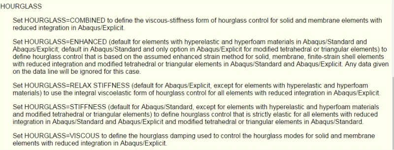

The Enhanced hourglass control is said to be winner allover, but I often find Relax stiffness to produce better result. I think Relax stiffness is the default for C3D8I/C3D8/C3D8R in Abaqus as well?
RE: ABAQUS/Explicit: Guideline on Hourglass control energy limit?

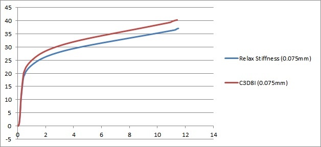

Load-displacement: (C3D8I vs C3D8R)
Hourglass control for C3D8R:
So it seems that Relax stiffness produces better result than Enhanced hourglass control. Any comments?? Also, is Relax stiffness the default hourglass control for C3D8R element?
I'm surprised you see such a massive change in your load-displacement results. But then I don't know anything about your analysis/model. Enhanced hourglass controls are generally beneficial, but can yield an overly stiff response in problems displaying plastic yielding under bending. That's straight from the manual.

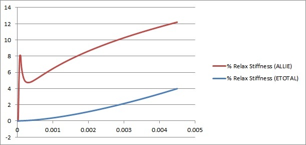

@Dave442 - Yes, look at the bottom two images.
For left image -
% Relax Stiffness (ALLIE) = (ALLAE/ALLIE)*100%
% Relax Stiffness (ETOTAL) = (ALLAE/ETOTAL)*100%
Same calculation for the right image (% Enhanced).
Do you think ALLAE values are too much??
Sorry, I didnt realize what you had plotted. The ALLAE/ALLIE % seems high for both hourglass control options. Can you share the details of your analysis? I guess its good that you don't see much difference in the load-displacement response for C3D8I and C3D8R w/relaxed stiffness option. Is it possible to compare to physical measurements?

Now with this 0.075mm element size:
Have you evaluated the effect of mesh refinement on the ALLIE/ALLAE %? Your mesh looks coarse and refinement should reduce hourglassing:

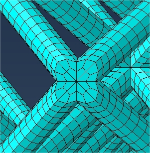

Here is the latest meshing, does it look good enough? -

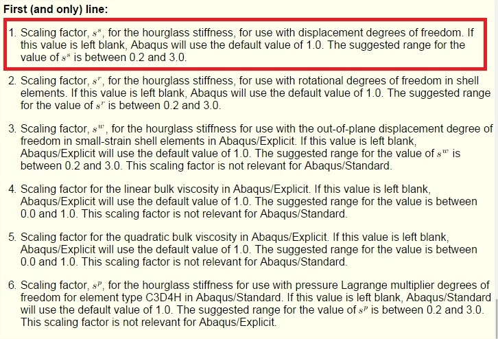

One thing to note that, Whatever hourglassing I'm using, the displacement hourglass scaling factor is set to 1. Should I change it?
Your mesh looks a bit coarse if they are C3D8R's but its up to you to establish convergence.
Your model looks like one repeating structure that is mirrored/patterned multiple times. Maybe you could run your sensitivity analyses on this small section alone? Just to quickly determine the effect of mesh refinement, element type and controls on your results?
Also, have you checked the critical element in your mesh? Sometimes when copying/merging instances you can make small sliver elements which are almost impossible to detect by eye. In an explicit analysis, these sliver elements will torpedo your stable time increment.
Just some suggestions, not sure about the displacement scaling factor - never alter it myself.
@Dave442 - From Abaqus docs on stiffness scaling factor - http://www.egr.msu.edu/software/abaqus/Documentati...
So I varied the scaling factor and the results are below. Note that scaling factor less than 1 (default) causes softening effect, I imagine value greater than 1 will cause hardening effect but the hourglass control energy will increase too. I terminated the analysis for scaling factor 0.5 since its showing the same trend in both load-displacement and Hourglass control graph.

You are trying to get your C3D8R results to match your C3D8I results. But you don't know if your C3D8I results are accurate.
As I stated before, your mesh looks coarse. Although your assembly has 380,000 elements, your 0.075 mm mesh has ~4 elements through the strut diameter and ~8 elements around the strut perimenter (not sure how much better this is for the 0.06 mm mesh). This level of refinement may not be adequate. Particularly if the struts are subjected to bending. Additionally, the performance of C3D8I elements deteriorates considerably if the elements are not rectangular. When the elements are trapezoidal, for example, their performance is not much better than regular displacement elements. Looking at the elements through your strut cross-section, they appear to be trapezoidal.
You can find this info in the theory manual: "Section 3.2.5 Continuum elements with incompatible modes"
You need to establish what the actual force-displacement curve looks like and use that to determine an appropriate discretisation scheme.
