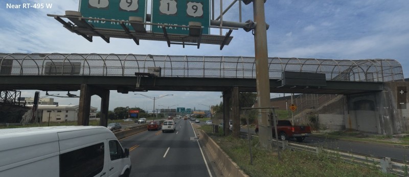

I have a client that wants to provide a fence for a pedestrian bridge. My job is to provide calculations proving that the fence works as designed. The fence is providing a complete enclosure of the bridge because a METRO train runs above this pedestrian bridge. I was told to follow the 1997 AASHTO Guide Specifications for Design of Pedestrian Bridges. This guide does not mention anything about railings or fence. So I am referencing AASHTO LRFD Bridge Design Specifications Section 13.8.2 which gives design live loads for railings and fence.
So here is my question: If I have a complete fence enclosure over the entire bridge walkway, do I need railings? I can't find anything in the code that tells me that I DO NOT need railings. This is just a pedestrian bridge. There is no vehicular traffic on this bridge.
I have attached (2) drawings. One drawing is a section through the enclosed fence. The other drawing shows an elevation of the fence. In the elevation, you can see how they have railings beyond the fence enclosure.
RE: Fence on Pedestrian Bridge - need railing?
If the fence can handle a 200 lbf lateral load or a 50 plf load in any direction, you would not need a railing.

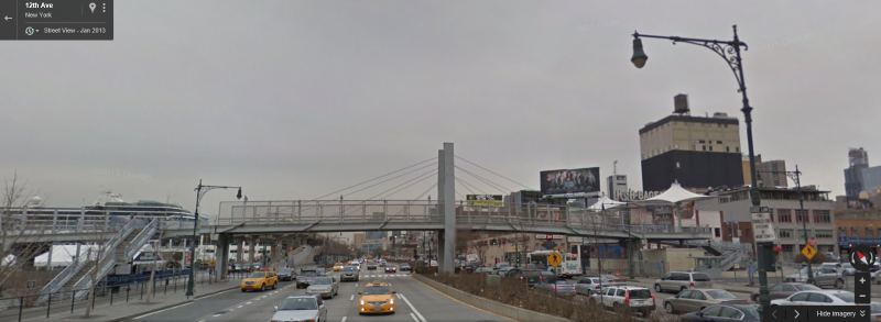

That style is at least a little more "open" ... A more circular arch - one that curves out a bit more, would be more attractive. Too damn bad we can no longer trust people to just walk in the open over a highway.
you still have some trusting souls here
