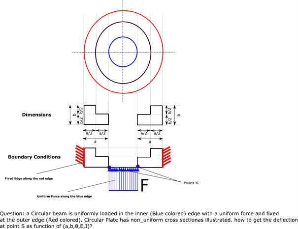

Hallo,
i would like to know an approach to this problem. i am stuck and can not find how to relate the angele in the solution because it is circular.
- please chek Photo
Best Regards
Timo

iI don't really understand your diagram. But regardless- with circular plates loaded and supported axisymetrically, see the circular plate formulas in Roark's Formulas for Stress and Strain. For non-symmetric load cases or supports, you can often make some approximations (yield line analysis, etc.) to show adequacy, but getting a reasonably accurate estimate of deflection would be likely be a finite element problem.

Hallo Stephan,
i guess this is advanced Strength of material problem or as you said can be as 1d Element (FEM) represented. However, Roakers formulas are simple and can not be approximated to this problem because:
- a/b Ratio is too small
- non-uniform cross-section
i can solve this problem when it is beam. However this is circular corss section and the second moment of inertia should be integrated with respect to Theta. i am lost!
Thanks in Advance

FEA would be an appropriate design tool for this problem...if that is not an option, I would try to approximate the solution using an upper and lower-bound approach..
I am assuming there is only one conc load on the inner lip from the OP's sketch....
1. LOADING.
assume area of influence of the conc load is approx 1/4 of the circle....so I would find an equivalent
uniform load by dividing the conc load by the length of the inner arc of 90 degrees and apply this
equivalent uniform load to the whole inner lip....and use Roarks formulas.
I might even try a 45 degree area of influence and divide the conc load by that inner arc length to get
the equivalent uniform load....and then take the average of both approaches..
2. MATERIAL.
Case 1. Assume "d" is the thickeness of both the length "a" & "b"...solve..
Case 2. Assume "c" is the thickeness of both the length "a" & "b"....solve..
add 75% of the difference in results between case 1 and case 2 and add it to case 1....one can vary the 75% depending on the length of a and b.....
material cost should not be a factor in this unless one is making a 1000 of them so I would tend to be conservative in my assumptions...engineering judgement will be involved ,as it should be in every engineering problem...

On that small a edge plate that thick, with that large a internal diameter, you'll be very close to make a linear assumption to start with.
RE: Deflection of circular plate with hole
without any dim'ns we're just guessing ... you might approximate the problem to a beam1 unit wide, cantilever at one end ... but that's clearly a conservative assumption.
you could consider the smaller ring (the one with the load) to be supported by the larger ring ... ract the applied point load around an arc ... +-30deg ? +-45deg ? +-90deg ... uniform reaction, cos(theta) varying reaction ... reacting the applied shear, and a bending distribution reacting the moment. Then guess some more with the larger ring ...

Are members (rings ?) "a" and "b" welded together then welded to "c", or are they all made out of one piece with the "fixed "c" ring?

-your approach is correct for certain accuracy. Roakers formulas are useless for an Engineer who want to understand the origin of these formulas. i dont want to use blind approach without analytical derivation. and in the internet i couldnt see derivations of roakers formulas!
-I am not talking about cost of material and production. this problem pop in my mind and i wanted to know how to solve it step by step !!ANALYTICALLY!!; it is not a projekt or ...
However, Thanks in Advance!
@racookpe1978
As explained i am not talking about dimensions i need a solution as function of (Roh, E, I, a,b) i am not taking values seriously i need to formulate or derive to get the solutions which may look like: deflection=EA/3I*(a/b).... and so on. but thanks at least you have tried.
@rb1957:
good Engineer dont need dimension to derive strength of material problem. These are variables a, b,....so i need solution as function of(Roh, E, I, a,b). but thanks at least you have tried.
@: No they are all made of one piece.

I would model it as a cantilever beam with two different I's, using an average width for each part of the stepped beam, with a proportionally wider cross section for the deeper part of the beam. It won't be an exact answer but I am a practicing engineer, not a professor.
