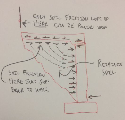

Say I have a basement, 12 ft tall from slab on grade basement slab to top of plywood sub-floor. Floor construction is 24" deep floor trusses.
One the other side of the basement wall is all fill, and instead of a wood floor system, i have slab on grade at almost the same elevation as my plywood sub-floor.
My original thought was to design as a cantilevered retaining wall with all surcharges as required.
Owner comes back and says no cantilevered retaining wall, they'll just temporarily shore the wall.
So then lateral forces at the top of the wall must get resisted in one of two ways: send the earth force at the top of the wall into the plywood diaphragm and block the hell out of it..
Or develop the top of wall forces into the high concrete slab on grade with dowels.
Any thoughts on the things i should check when choosing the latter?

I believe that some of the trepidation that you're hearing here regarding the SOG solution comes from concern for mobilizing soil friction which would just end up getting transferred back to the wall again as additional soil pressure. You ultimately end up needing to reach out quite a ways beyond the wall for reliable tension resistane. I tried to convey the notion in the sketch below. Let me know if it's inadequate. I'm finding this a difficult thing to describe for some reason. I guess I'm saying something along the lines of "circular load path".

1. You will need to ignore any resistance of the first 18 ft or so of the slab since it is being resisted by the retaining wall you are trying to support - pulling yourself up on a falling rope
2. Slab on grade will need to be designed to ACI 318 standards - it is now a structural slab and not just a slab on grade
3. Consider the possibility that a sewer line or something will need to be trenched and the slab will be cut.
4. You will only get a small amount of shear friction from the weight of the slab on the soil.
5. It is fairly standard to put this lateral load into the plywood flooring system.
6. You will need to develop the reinforcement on both sides of any control/construction joints - don't use dowels to allow volume change.
Not saying I wouldn't do it (I have), but you should have some very good reasons to support this uncommon solution.
RE: Resisting Lateral Forces at Top of Foundation Wall
7. Strain compatibility. You might need 1/2" or more of axial displacement in the SOG to resist the lateral load imposed on it. How much load will be absorbed into your diaphragm once that movement occurs?

It might be time for another sketch to illustrate what you're suggesting. Based on what you've told us above, my understanding is that the SOG is acting as a tension tie and not as any kind of beam/girt (be it a big one or a bunch of little ones. If that's true, then you just need to go far enough past the retained soil with the designated tension rebar to feel comfortable that you've developed your soil friction beyond the vertical line in my sketch above. I've never seen it before but I suppose you could even introduce a shear key into your SOG kinda like we use sometimes on retaining walls. Like I said at the top though, I'm not a big fan of the system in general.
He's saying the slab is a tension member that is ANCHORED AT THE FAR SIDE into the foundation wall over there. No soil friction would be involved.
So lateral resistance will be provided by SOG attachment to an entirely separate building? I'm liking this less and less all the time.

Thanks for the sketch. Grabbing the wall is certainly better than not grabbing the wall. As others have suggested though, a quantitative analysis should still be performed.
Is there soil backfill up to a similar height on the opposite side of the basement?
