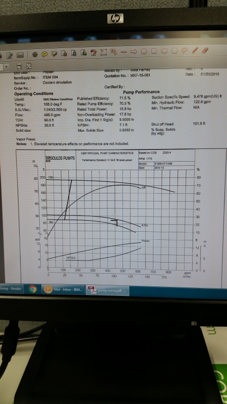

Ok, experts need your opinion on this..
I'm designing a cooling glycol circulating pump which is used to cool the inter-coolers and after-cooler of a fairly big Nitrogen compressor. This is a closed loop system where the pump discharges in an air cooled Heat exchanger, then to the compressor and back to the pump suction/glcyol expansion tank.
The design point is 465 GPM at 90 ft of head: Pump curve attached
The shut-off head is 102 quite close to the design point
The questions:
1) Whether the flat pump curves poses any issues related to operational flexibility. If during operation there is a need for a higher head the pump would then not be able to deliver any head more than 100 ft
2) The location is north Canada where ambient temperatures are low and this results in lower glycol temperatures. The operation folks would then throttle the compressor coolers valves on return line to control the temperature. Does this have any adverse affect on the pump operation with this flat curve?
Your comments/opinions are greatly appreciated

Some questions:
- Did you buy the pump ? Competent pump vendors will supply custom pump curves for a variety of viscosity and SG conditions .
- Flat pump performance are undesirable for a variety of reasons .... but usually indicate that a "cheapie" pump was selected by cost savings management. Operational problems, of course, will be addressed by the field engineer.
- Is there a single pump in this service or is there an installed spare ? ( also called A/B configuration)
- Is the pump(s) on a VFD ?
- Why would there be an increase in pump head for a closed system ? Why would there be a need to throttle the pump discharge ?
- Winter/Summer system temperature control should be achieved by a bypass throttle on the coolers. Do you have such a bypass ??

OK,
Even without the pump curves, the issues are there to be answered.
Your issue is how to marry your pump to its system curve.
A flat curve is not such an issue providing that the system curve is relatively steep at the duty point and you've only got one pump working ( i.e. not in parallel)
You are correct in that if the system needs more head then your pump doesn't have it, but that's true of most pumps.
so long as your flow is more than 50-60% of duty.point, your pump should operate Ok at lower flow. The flow might hunt a bit more if the flow is controlled by a fixed pressure drop, but without data it's difficult to judge this.

Hello All:
The pump hasn't been bought yet.
Yes there is a bypass around the air cooler
The pump is fixed speed and a single pump operation
The pump curve is steep beyond the duty point

Flat curve: applied on closed piping systems with modulating valves. A flat-curve pump provides good pressure regulation where the flow rate fluctuates rapidly.
With a flat curve, the head rise is limited at reduced flows. A very high head rise as a result of closing control valves may cause problems. Excessive flow rates through the coils and greater pressure differences across the control valves are some of the problems that can be avoided with a flat pump curve.
Steep curve: usually for open piping systems (cooling towers), with high pressure, constant flow, multiple pumps systems. The use of steep-curve pumps is sometimes desirable because they permit some adjustment of the discharge pressure without changing impellers.

Unless you are very sure of your total head calculations, I don't think this is a good pump selection, a small change in total head could result in dramatic shift in flow. However without the total system head information (system curve) it is difficult to give you good meaningful information.
However the impeller selected in a reduced diameter allowing for performance change if necessary and if unsure if your final duty, maybe you should consider a baseplate configuration that will allow a motor size change.
RE: Pump Curve question
Without seeing the system diagram or system curve it's difficult to work this out as artisi says.
You really need some sort of flow control on this system or you could easily go off the end of the curve with only a small change in system curve.
