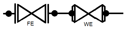

Ok, we're having a debate internally here about what is "normally" done on a P & ID.
Do you
A) Show deliberately a little vertical line next to each flanged valve to indicate it's a flanged valve or
B) Assume all the valves in a plant are flanged valves.
If B how do you show when it is deliberately a welded end valve you want (e.g. last valve going into a long gas pipeline)
I've seen both ways and A really annoys me as you get little lines all over the place and then you can't see it or it gets lost in all the other data.
We're talking fairly basic P & IDs here, not the all singing all dancing "intelligent" P & IDs.
Spool pieces, blind flanges on e.g. drain valves are shown but "normal valves"?

If all valves are flanged, then no, a simple general note, "All valves flanged, except as noted otherwise." should do the trick.
RE: Do you show flanges on a plant P & ID?
It DOES HELP on P&ID's to know what joints can be broken for temporary fittings, flush or hydro connections, Backwards flow attachments, blind flanges, or blank connections.
The "dot" and "line" connections in Big Inch's sketches above are the usual practice, and they should be encouraged.

It think the thing to do is to generate a symbol for a weld end valve - does anyone have an example? - and then assume all are normally flanged.
Flanges on vessels, flanges where you specifically need to show them (removable spools, spectacle blinds etc) are in there and seem a good idea.
The symbols BI has loaded to me are more isometric piping drawings to me and I've never seen a weld dot on a P & ID.

You show no special symbol for welded end valves or any valve (other then type i.e ball, gate, globe, & etc.) the piping spec for any line "should" dictate what type of valve it is (flanged/weld end/screwed/SW). I agree with Kern oily on use of a SP number for any "odd-ball" items that may be generated.
