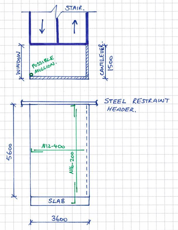

Trenno, if the wall is 5m high without any intermediate restraints then it is too slender, the max slenderness in NZ masonry code is 20 times the thickness, i.e. 3800mm tall is the max height between restraints for a 190 thick wall. Its even less if the wall is cantilevered from memory. Restraints can be vertical or horizontal.
RE: New Zealand EQ Detailing & Design Issues
Hi Agent666,
I have the following situation. You mentioned restraints could be vertical. If we put in a vertical post, as indicated on the sketch, I wonder if we could then span the block horizontally between the post and return?
Yeah I don't see why not. Might want to consider a small return on the block wall or a 400x400 pilaster that way you don't have to connect the post to the masonry wall (and post likely to be less stiff than the masonry anyway).
