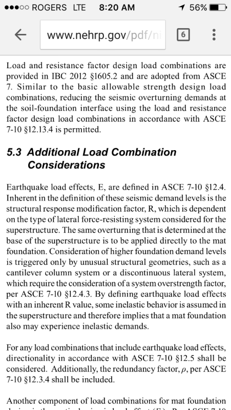

ASCE 7 requires in certain circumstances that the seismic loads be modified by rho, thus Eh = rhoQe per 12.4-3. Is this amplification required to be transferred to the foundations?

I can't find anything that says it doesn't apply to foundations. ASCE 7-10, Section 12.3.4.1, lists elements that can be designed using rho=1, but foundations aren't one of them. Rightly or wrongly, I have always assume rho=1.3 applies to foundations for seismic design categories D thru F when using the equivalent lateral force method.

NEHRP's design guide for the seismic design of mat foundations (Link) instructs designers to apply rho. See the last paragraph below.
