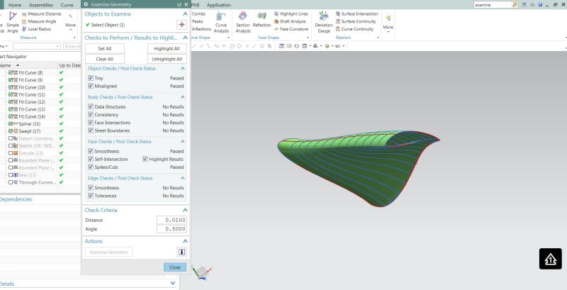

RE: Wind Blade Design - "Through face does not intersect path of the tool"
When boolean operations do not work when they apparanetly should, the first thing to do is run "examine geometry" on the bodies and faces. Your blade solid has both body consistency and face self-intersection errors. When these are fixed, the unite will work.

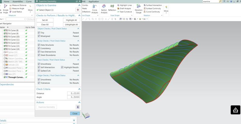

Yes, that was my first observation as well and since ALL of the 'problems' were pointing toward the solid body representing the airfoil, I looked at how it was constructed and while the profile curves looked OK so I decided it must be the method you used to create the airfoil surface itself. I therefore used a 'Surface Through Curves' instead and then used a 'Shell' operation to get the hollow body. Then there was no problem getting the tho resulting solid bodies to Unite. I've attached my effort below. Note that it passes all the 'Examine Geometry' tests that one would expect it to pass. I also left your old airfoil in the model but its features are currently suppressed.
Hi All,
I want to thank you for all your reply. It helps me a lot learning NX.
I have examined my curves and solid bodies built by two different features (Through Cruve/Swept)
The curves has no self-intersect error, but both two solid bodies has this issue.
I will see where I did wrong compared to John's model.
Did you look at my 'Surface Through Curves' resulting Solid Body? It passed all the tests except 'Smoothness' but that's just telling you that there are hard corners, but that's to be expected.

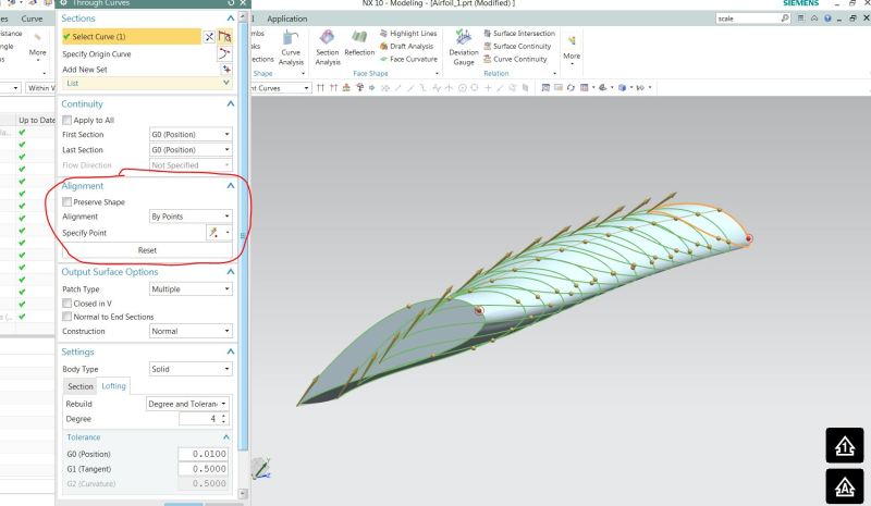

Hi John,
I believe I used wrong Alignment options in Through Curve feature. I used "parameter" option and the result has self-intersect error. If I switch to "By point" option, the result is perfect solid with no error.
Again, thank you for your help.

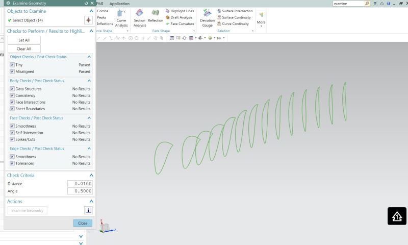

I do not agree on that the construction is ok.
I hope you take the following as constructive critic and not negative.
1) The model size ? The cylinder in the center is 3 millimeter in diameter !?!
I can understand the size if this is a fan, but a wind blade ? Or are you modeling is scale 1:something ?
2) all these sections, having this many sections for this shape tends to "overload" the resulting surfaces. You simply cannot have input data which is accurate enough to produce smooth surfaces.
3) The sections themselves, You have used a fitting tolerance of 0.0001 millimeters. This is very tight, and i assume that you have fitted this to something which came out of a CFD simulation ?
In the CFD simulation the accuracy was what ? ( i doubt that it was lower than 0.0001, rather say 0.1mm! CFD systems are not designed for extreme accuracy, rather to crunch enormous amounts of data. Plus they do it on elements which are either linear or "cubic".)
Have you looked at a curvature comb of one of the sections ? The sections are far from smooth. Turn ON the curvature comb when you do the fit splines and you will see the result of this extreme tolerance.
Zoom in on these sections, Update the display and you can see the undulations in the sections. In the image i have highlighted one section with curvature comb and one section without comb. The periphery of the comb exaggerates/ illustrates the undulations.
See attached image.
The resulting face, there is only one face, has a G0 ( position) tolerance of 0.01 mm to the input curves, which actually will smooth out some of the undulations in the sections.
If you would use the same tolerance on the sheet to the sections, it will be rather ugly.
I agree on the method John proposed, a Surface through curves is a simpler and better method.
Suppress the surfaces. Go back and edit each section such that you get a balance between shape ( look at the curvature comb) and tolerance to the input data. Try to have a consistent number of segments in the splines, the surface will be simpler ( (less data )smoother and by far faster to work with. Subsequent features such as Unite, shell/ offset, blending etc will work without trouble, updates etc will work .
See if you can skip every other section but keep the shape / position.
The surface can never be better than the input curves.
Regards,
Tomas
