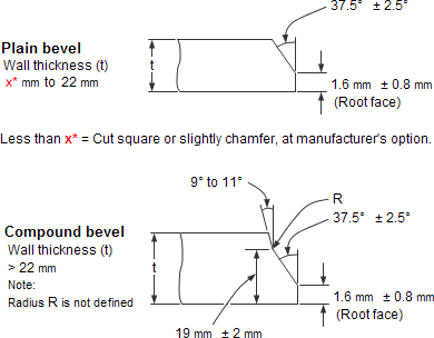

Gator provides a good illustration. Since we are talking about 10" sch 120, t = 0.844 (21.4 mm), only the plain bevel illustration applies. The note "less than x = cut square or slightly chamfer, at manufacturer's option" means that the manufacturer can chamfer the bevel larger than 37.5 deg, at the point of 0.844", which is exactly what we are seeing in the photograph. This is also what is being illustrated in Table 12 (a) of ASME B16.9

Weld End Preparation at Unequal Wall Thicknesses
In most piping systems there are components such as valves, castings, heavier header sections, and equipment nozzles which are welded to the pipe.
In such instances the heavier sections are machined to match the lighter pipe wall and the excess thickness tapered both internally and externally to form a transition zone.
Limits imposed by the various codes for this transition zone are fairly uniform.
The external surface of the heavier component is tapered at an angle of 30° maximum for a minimum length equal to 1.1/2 times the pipe minimum wall thickness and then at 45° for a minimum of 1.1/2 times the pipe minimum wall.
Internally, either a straight bore followed by a 30° slope or a taper bore at a maximum slope of 1 to 4 for a minimum distance of 2 times the pipe minimum wall are required.
The surface of the weld can also be tapered to accommodate differing thickness. This taper should not exceed 30°. It may be necessary to deposit weld metal to assure that these limits are not violated.
Below some tables with acceptable design for unequal wall thicknesses acc to ASME B31.8

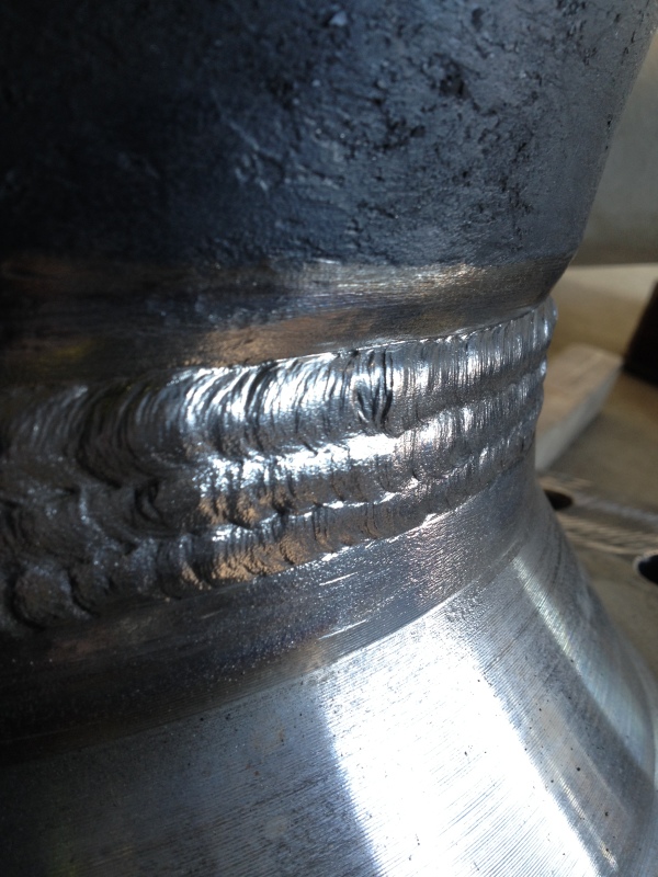

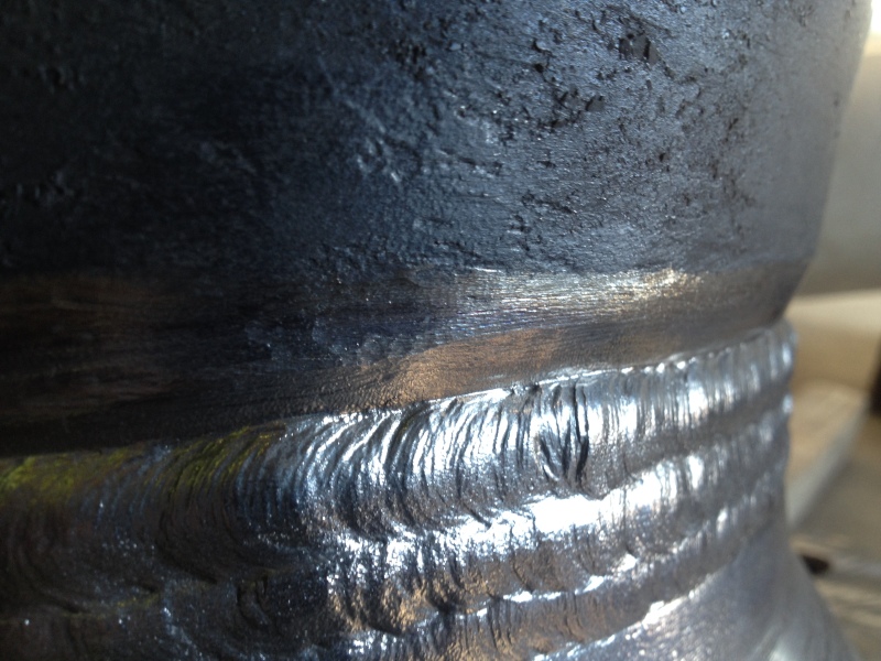

This is how it looks after welding. Taking in account that the medium it's H2S, I am more worried. The bevel between the weld and the elbow in some part it's very sharp, so in this case it's possible to be a stress concentration point.
Best regards.
RE: Elbow with extra bevel
Nothing in those pictures looks off or ill to me. If you are concerned with stress raisers at a sharp point, you can grind them smooth or blend grind them.
