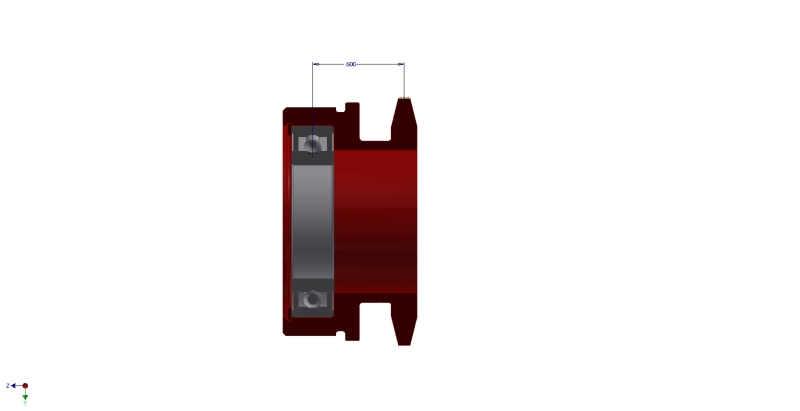

I have an application where a roller chain sprocket hub is supported by a single deep groove ball bearing that is supported by a 20mm shaft. In order to get the sprocket tooth count to a low enough number to support the application, the sprocket is situated adjacent to the ball bearing (to clarify, the OD of the bearing is larger than the required ID of the sprocket, creating the need for the offset). This obviously creates a moment/tilting load in addition to the radial load that is applied by the chain. I would like to hear your input on the feasibility of using the following bearing based on the following speed and loads:
Bearing: 6804-2RS
OD: 32mm
Width: 7mm
Dynamic Load Capacity: 900 pounds
Static Load Capacity: 594 pounds
Maximum shaft speed: 4000 RPM
Maximum Radial Load: 288 pounds
Maximum Tilting Load: 14.4 foot pounds
There is already a product on the market that uses this exact same setup so I know that it works. I am simply trying to understand what the margin of safety is.
It is not possible to add a second bearing and it is not possible to increase the bearing size.

RE: Single deep groove ball bearing, radial load offset from bearing centerline
Mike, thanks for the feedback. I've attached a picture showing a section view of the sprocket and bearing. The sprocket connects to a clutch that is driven by the keyed shaft that the bearing rides on. The clutch is not shown for proprietary reasons.
i know for sure that my competitors product uses a standard deep groove ball bearing, although it sounds like a 4 point bearing would probably be the best option.
Mike,
Your comment as to whether my competitor might have some sort of radial bearing has got me thinking...
A clutch basket is secured to the sprocket and that clutch basket is essentially splined to friction plates. Those friction plates that are clamped concentrically to a flywheel that is keyed to the shaft that the whole assembly rides on. I believe that as the clutch is engaged, the forces applied to the sprocket increases (bad), but the clutch basket starts getting supported by the driver via the friction plates (good). In effect, the moment load is not completely taken by the ball bearing.
