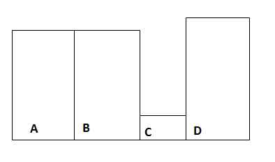

Ok, I have calculated 317.5 total flow for one builging and I have 4 buildings in total (2x14 stories, 1x5 st. and 1x17 st.). For Class II hoses and sprinklers in every level do I have to consider adding the flow of all buildings for the pump calculation?
RE: Sprinkler system design
Do you have any scenario where all four buildings would be on fire at the same time? Likely not. We typically base the pump size on a single area in a single building.

We have 4 buildings in the same project and that`s why I had this doubt about the manual, guess I have to study more over the weekend (smile thanks again:
