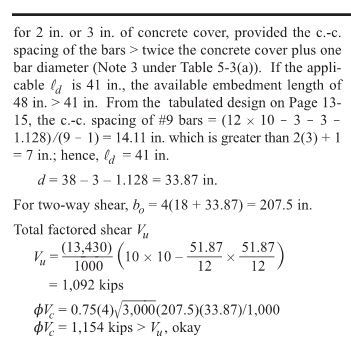

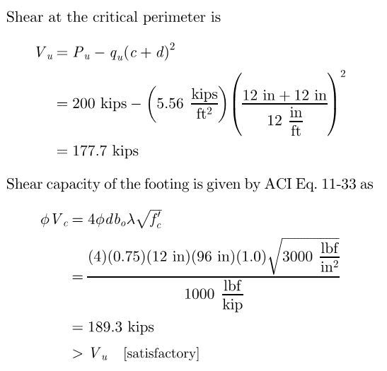

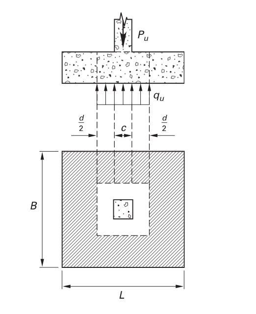

Here are two examples. I have mixed feelings about the exclusion practice. In cohesive soil, it may underestimate the demand imposed on a brittle resistance mechanism.
