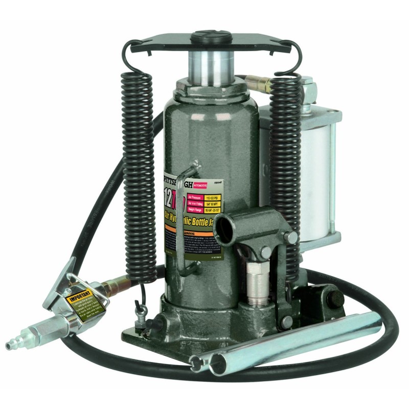

can you guys help me, giving some ideas on how to automate a manual hydraulic machine that uses a hydraulic jack, or we can use other type of component to press any object.
Here the structure so far:
I would really appreciate if any of you guys could share any ideas, that would be awesome :)

actuator to replace the human pumping the handle? motor on the release screw?
replace with other hydraulic/servo press?
you don't give any details on its function/forces involved/budget/cycle times/etc.. so an alternate suggestion is impossible.

Replace the bottle jack with a normal hydraulic cylinder actuated by directional valves and a hydraulic power pack.
Be very careful. A mechanism like this is potentially subject to safety standards that apply to power presses. Due to the significant potential of someone having fingers, hands, or arms flattened, these standards are very stringent. If you don't have experience with this sort of thing, it is likely time to call in the experts - there are plenty of companies that specialise in power presses and would know what needs to be done.

Check Enerpac cylinders. Control with standard solenoid valves, flow controls, and switches to achieve the motion desired. DO NOT ignore BrianPeterson's advice above! Be aware of all safety requirements (OSHA, etc).

If all you want to do is to reduce the amount of manual pumping required, you can buy a pneumatically driven manual jack for very little money.
If you truly want to automate it, you will need to do a lot of work or a little, depending on what the intended purpose is.

If you read my post, what I suggested was pretty clear:
Such a device is, in every meaningful way, STILL a hydraulic jack, with no significant worries due to the compressibility of the working fluid since it is merely used to operate the jack pump mechanism.
The term "air over hydraulic" does not properly describe the device I suggested in my opinion.

Great photo - havent seen one of those before - gets a star.
