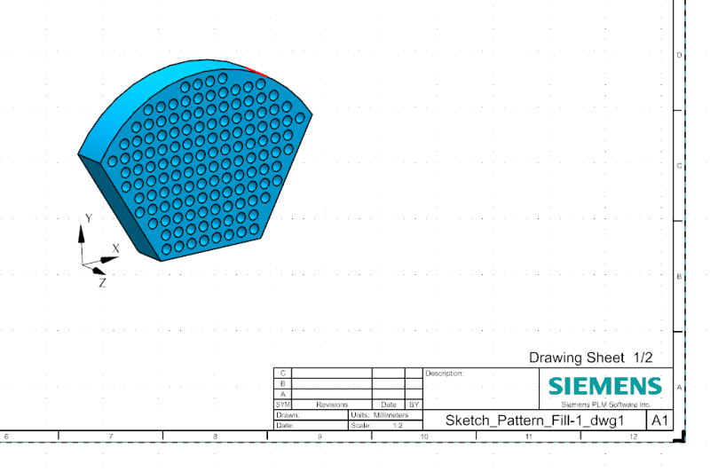

What I'm mainly looking for is a good way to do this with non-standard "isometric" views. In some drawings I have to show many non-standard views and would like to be able to place a symbol in the drawing that I can move around to locations that make sense in the drawing view. I would like it to be able to inherit the correct coordinate directions and labels from the view I'm placing it in.

If you add the WCS object to the master part file, when it's displayed in an isometric view on the Drawing, the SYS will also be oriented as in an isometric view as shown below:

For what it's worth, knowing what all you require up front helps out quite a bit and gets you a solution faster rather than feeding bits of info as we reply.
Now that all that has been taken care of, John's suggestion is more than likely the best for what you're wanting to do....optionally, you could put the CSYS in the dwg file rather than the component to avoid switching between parts and dealing with Reference Sets.
To take care of the CSYS being visible in all views, put the CSYS on a specific layer and utilize Layer Visisble in View to control in which drawing views the CSYS is visible. I don't believe View Dependent Edit will allow you to erase the CSYS (why, I have no clue).
