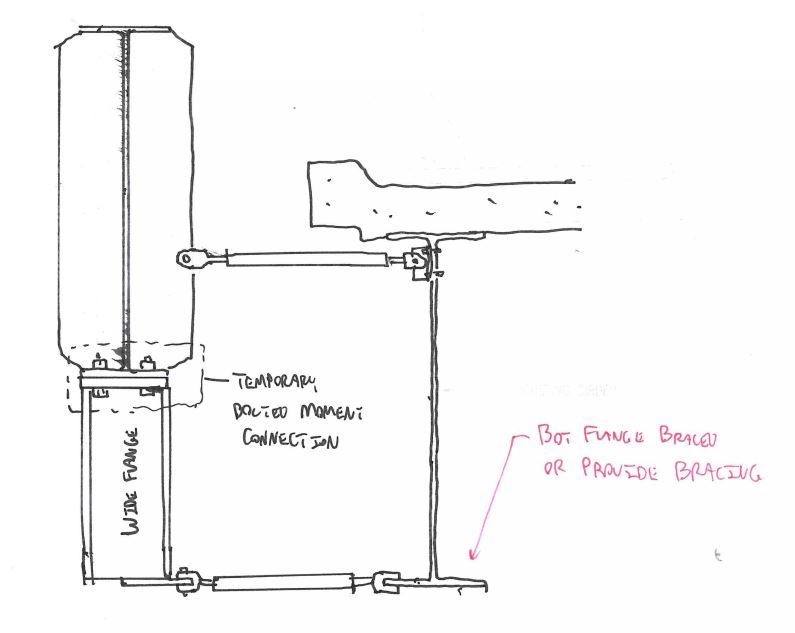

I like Teguci's concept of keeping the braces horizontal so as to minimize transmission of vertical forces. However, I feel that all of your details are working that little nub of curb concrete pretty hard, particularly the details that rely on the moment capacity of the nub.
I propose the torsional bracing detail below. I believe that it would have the following features:
1) Horizontal braces again.
2) Doesn't damage the concrete.
3) Convincing LTB restraint for both positive and negative bending regions (not sure if this is a simple span or continuous girder.
4) Ought to be about as economical as your details.
I'm assuming that the bottom flange of the existing girder either is, or could be, braced laterally.

Hi Kootk,
Thank you for your comments and preference.
However, we are not allowed to drill and/or weld into the new I-girder.
For my curiosity, could you please let me know why you want to add the stub (wide flange) and have the new strut go perpendicular to the existing girder instead of connecting new strut to the lowest bolt hole on the gusset plate of new girder?

RE: Bracing of Welded I-Girder
I agree with Koot's method for bracing. It's far more efficient than relying on the concrete nub to transfer the forces. I believe he's keeping the bracing horizontal to prevent transmission of the vertical forces as Teguci mentioned.
You could also moment connect the stub to the girder stiffeners directly. That would be easier really. Just use a longer stub and run it up the left side of the new girder. Remove them one at a time as you add in permanent bracing.
I used horizontal bracing between girders, arranged as shown, for three reasons:
1) limited transmission of vertical displacement between girders
2) healthy torsion lever arm on existing side.
3) healthy torsion lever arm on new side.

KootK had suggested a moment connection between the stub and the (existing?) girder stiffeners
You'll have to be more specific RHTPE. I recommended a detail specifically designed to allow differential girder deflection. It involved a stub wide flange moment connected to the new girder as shown in my sketch above.

I just take a closer look at the posts & details and realized that our preferred detail will not work on horizontally curved I-girders because of of the tendency to rotate about the line/axis (connecting the two ends). Normally, to stabilize single curved I-girder, we would use a holding crane or shoring tower (placed as close as the girder's gravity center as possible - when pair lifting is not allowed/possible).
Let's take a fresh look at the details and see what can we use them for:
- For LTB: Kootk's detail, Detail 1, 4 would be okay.
- For weak axis bending (from wind loads, in case of disruption in erection and no possible tie-down): Kootk's detail, Detail 1, 3 & 4
- For rotation due to horizontally curved profile: Detail 4
