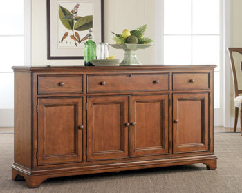

We just bought a mountain house in NC. My wife has purchased a buffet I guess it is called and I am very concerned about the weight of it. It is about 6' long and 32" high and will be getting placed in the kitchen where there is just an empty wall with no cabinets. It is a wood piece but it is very heavy. The kitchen is on what I would call the second floor although it is really the main floor of the house. There is a finished basement below it but it is more at ground level than actually be a dug out basement. I know this my sound stupid but I am just concerned about the weight of this item being too much. There is not a supporting wall located directly below this part of the kitchen.
Does anyone have an opinion on something like this? What should I be looking at? Am I worrying about nothing? Thanks for any input or help that you might be on this.

If the house is designed and constructed in accordance with accepted practice, the buffet loaded with dishes etc. is not a problem. But we can't tell from here if the structure is adequate.
RE: Could heavy piece of furniture be too much for second floor of house?
Some sort of sketch and other details required to make sense of this.
Such as - this thing - what is its estimated all up weight? how many feet does it have, what is the floor made of, where do the joists run, how big are they and what other weights are carried by them, what condition are they in?
Locating it next to the wall is a good idea to reduce bending load on the joists, but not enough detail here to provide any level of judgement.

It also depends on the direction of the joist span. If the joists are parallel to it, that might be a problem, if perpendicular, that would be better as the load is ditributed among many joists. I see this occasionally with heavy bookcases.
If the house is designed and framed properly, i.e. in accordance with a building code, the only pieces of "furniture" heavy enough to worry about in terms of floor loading are bathtubs/spas full of water and stone or masonry fireplaces. Bookshelves? Never thought of that, but they could indeed get very heavy too. I doubt a buffet full of dishes would be a problem unless it is fitted with a 4" thick solid stone top or something like that!
Nobody here can tell you whether your "mountain home" was designed and built in accordance with an accepted building code. If you're worried, you'll need to hire a local engineer to assess it for you, and that's going to be costly.

Ok, guys. I was at the house this weekend and took a look at the structure of the floor. The joists under the kitchen where we are planning on putting the heavy buffet are I-beam type. I think they are called TJI type joinsts. They are 16" tall and are spaced 16" on center. They also run perpendicular to the postition that the piece will be located. Still don't have a weight on the piece but it is 69" long and it looks like the weight is supported on the front leg and all the way down the full length of the back.
This is out of my depth, but a quick look seems to say these joists have reduced dead load capability (10psf). There are though many different types of TJI joists. One thing they do seem to need is very good bracing to keep them vertical. see typical attached.
Maybe too late now, but photos of the beams, their bracing and what their bearing on are critical to understanding their capability.
As someone else said, your worst case might be actually moving this thing in not when it's in position.

The likelihood is high that if TJI joists were used, the floor was engineered at least to some degree (i.e. a span table was used to select the required depth and spacing of the TJIs) and you have little to worry about. As noted above, almost all furniture is not so heavy that it would exceed the pounds per square foot allowance used for the design of a normal floor. Personally I would worry no further but it's your house and your consequences if things were to go wrong.

Live load deflection L/360. Total load L/240. That's standard residential requirements.
I'm going to bet that the hutch does not exceed 40 PSF (or at least not significantly). It's almost 6' long and likely 2' wide. That would mean it could safely weigh 500 lbs without anyone batting an eye. And likely could weigh over 700 lbs before fear of collapse.

I'm assuming by buffet (I'd call it a sideboard) you mean something like this?
Even the lightest on of your beans has a shear load of nearly 2000 lbs. As the weight will be spread over 4 or 5, that's nearly 4 tons. End reaction is listed at half that, but that's still more weight than a piece of furniture.
Deflection or the strength of whatever the joists sit on might be an issue, but it looks to me like the joists are good enough.

Thanks. And when I say "buffet" it is like what your pic is of sideboard. Looks like I probably don't have a worry. Think I would have liked being a structural engineer. The stuff you work with is really interesting. Thanks again.

I very seriously doubt that there is a structural problem with the furniture piece that you describe.
Several things come to mind;
Most residential floors are designed of about 10 pounds per square foot (psf) dead load and 40 psi live load.
If the thing is 5 ft x 1.5 ft, at 40 psf, that would be 300 lbs. I would not expect it to weight that much but even if it is close, there is no way that there will be 40 psf all over the floor. That would be equal to 29 people in a 12 ft x 12 ft room if they each weighed 200 lbs.
Most likely, the main "problem" will be performance of the floor from someone walking across it and the china rattling. Vibration of long span joists is sometimes a problem of behavior (but not usually a structural problem in the sense of overload).
As others mentioned, IF the furniture is located near a wall, and the floor joists are parallel to the wall, you might find that the relative deflection of the joists is a problem in that the joist that is nearest to the wall will not likely deflect much but the first and/or second joist out away from the wall could deflect.
You mentioned that there is not a bearing wall nearby and below so, the thing might be located out near the midspan of the joists. Again, this might be a vibration problem. 16" deep joists tend to be used in long span conditions (although sometimes we see them in "two span" conditions). Long spans tend to have a higher deflection allowable since it is often based on a ratio of the span. Two span conditions can sometimes have vibration behaviors due to being overly stiff. I'd be curious about the span length and locations of joist support relative to the furniture.
I would guess the only concern would be possible vibration that might cause the china to rattle a little but it would be extremely unlikely that actual strength (semantics aside) will be a problem. As mentioned, each joist has a pretty god shear load capacity.
