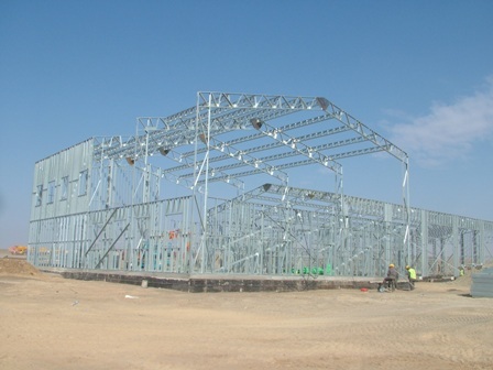

I am designing a shed with light gauge steel which contains the 28m clear span , so i am confused about the LGS truss support condition both supports of the trusses should be pinned support or one pinned and other should be roller however my truss are resting on the light steel wall.
please also suggest is it good idea to make 28m x 72m and 5.5 m height shed in light gauge steel , however i can use maximum section is C150-1.55 (no internal partition walls )
Roof Dead Load = 0.25 KN/m^2
Roof Live Load = 0.60 KN/m^2
Wind Load = 1 KN/m^2 (uplift)

One needs to pinned, one roller or you can do both roller and restrain the peak in the X direction. The supporting walls do not provide stability for the truss, the roof diaphragm does.
I have done alot of light gage truss design, and I would recommend going to structural steel for a span of this length. The analysis is difficult and the loads are going to be huge. There is lots of eccentricity in the connections that is hard to qusntify. Alot of web and chord bracing may be required which rarely ever gets done correctly.

if i go with webbed LGS portal frame after every 2m or 3m then what do you think is it possible to stable the structure ???? below are the design criteria
Shed Size 72m x 28m x 5.5m (Clear Height)
DL = 0.35 KN/m^2
RL = 0.60 KN/m^2
WL = 100 MPH (Location UAE)
roof slope can be considered up to 10 degree (but no limitations from client).
Purline will be connect directly on the truss top chord through screw.

Without seeing the final engineering documents I can only guess (or hope?) that the image you attached has some sort of bracing because those columns look inadequate for frame action.
Your attached picture has plates on the ridge that may server to transfer moment, a similar thing can be done at the knee to transfer moments, shear and axial forces and turn it into a portal frame.
Alternatively you can design braced side walls and provide a brace system in the roof plane to take the sway force back to the side walls.
